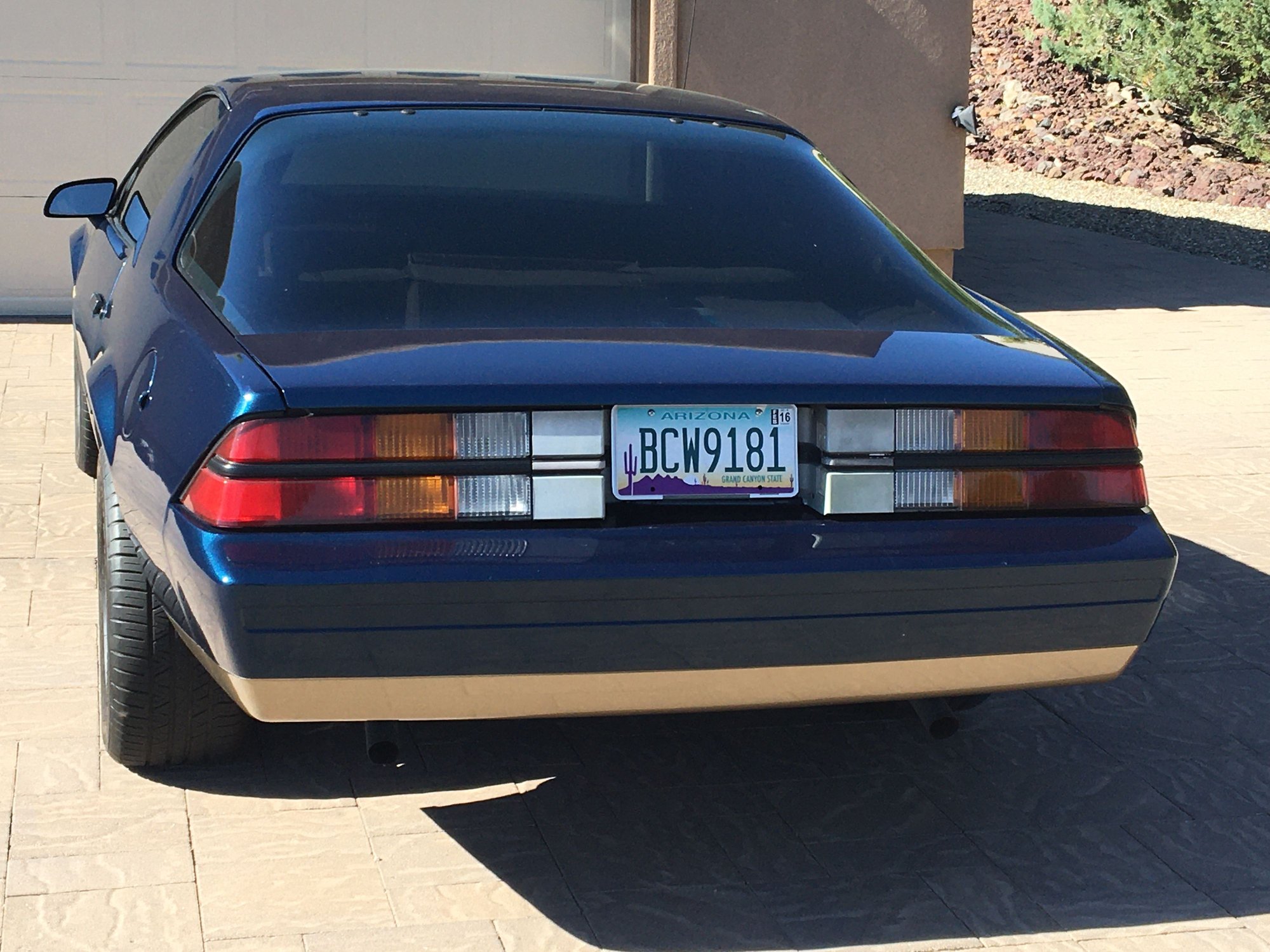

Got the 16" IROC wheels and 245/50-16 tires installed. All new suspension parts/sway bars/Koni adjustable shocks and new PowerStop brake calipers/rotor and pads installed as well.
I'll be testing the front shock adjustment today. Lowest setting is basically stock, I turned the **** 1/4 turn and hopefully that's a nice combination of handling and comfort. Here are some pics. Thanks to everyone for suggestions, recommendations and advice!
