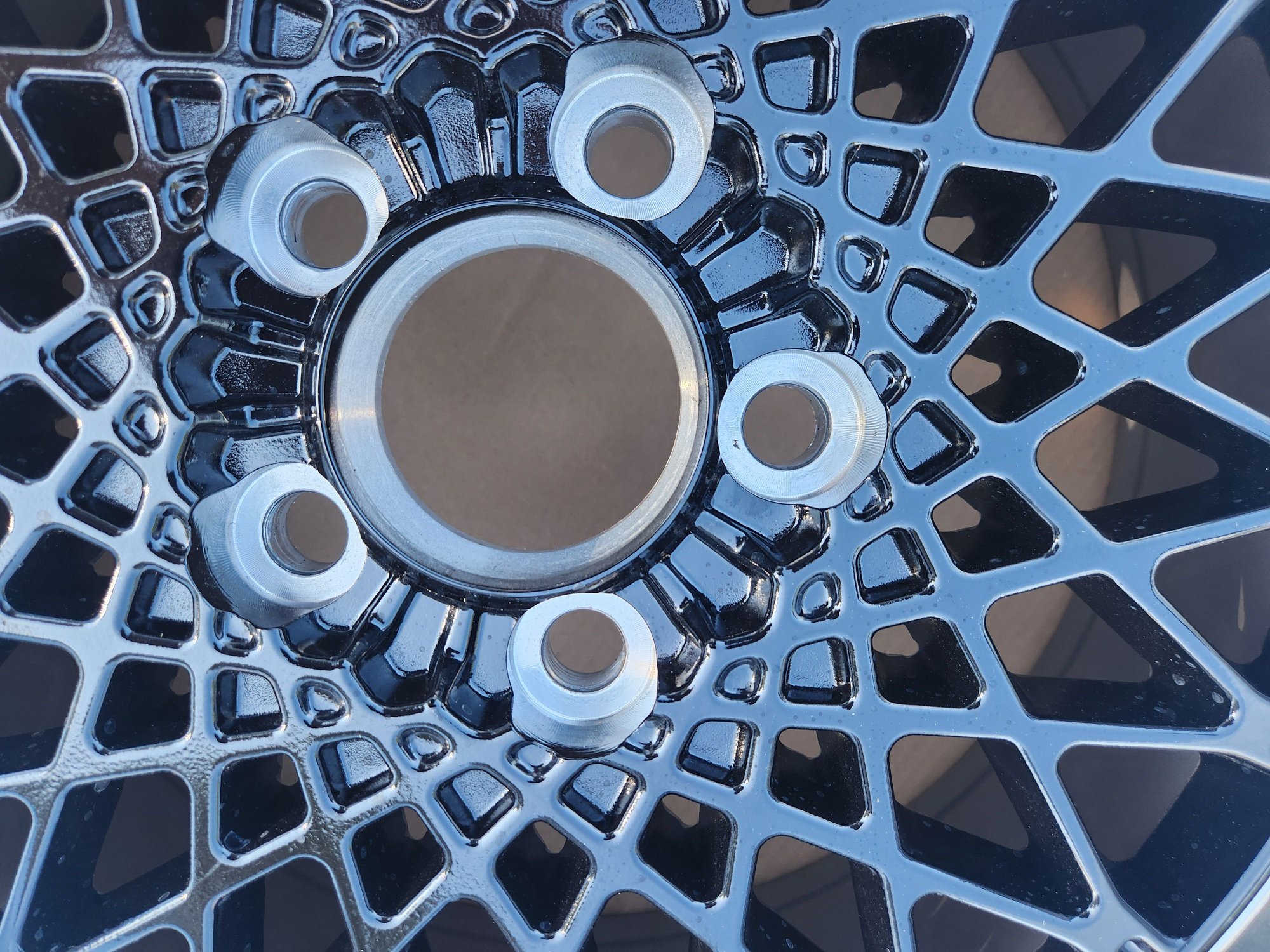

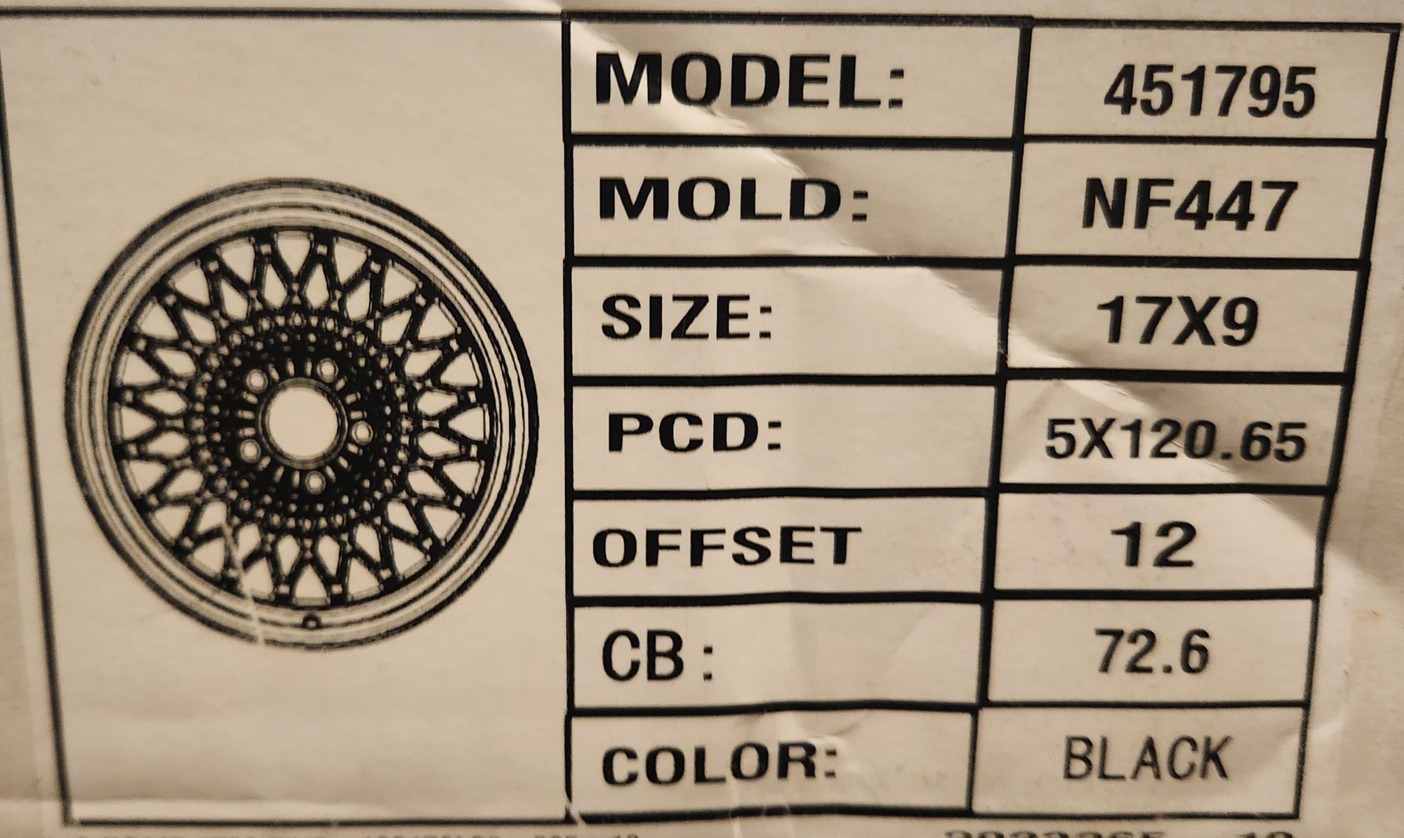

Posting this as a PSA to hopefully save someone else some aggravation. When researching here on TGO, there were a few people that mentioned the OER and Hawks versions of the 17x9 GTA wheels being the same. Based on those claims, I ordered a set of 4 OERs through a vendor who had a nice sale on them. Upon attempting to install, it quickly became apparent something was wrong.
The first issue is the machining of the lug bores and pockets. Notice the machining of the pockets breaches the first row of the crosslace pattern, illustrating the larger diameter of the cuts. More importantly, notice the lack of a tapered seat. These OER wheels are designed for mag-style lug nuts.

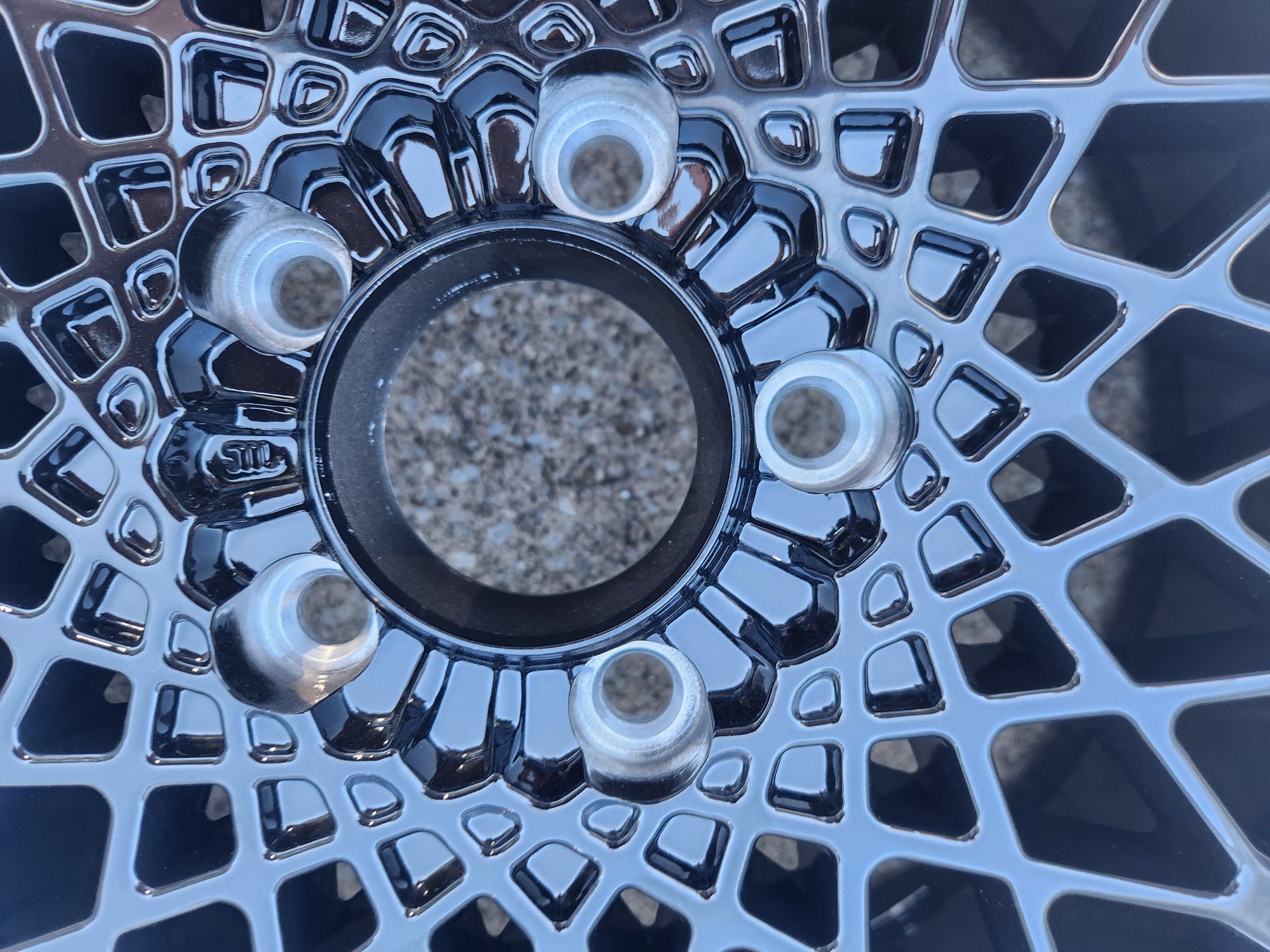

Here's the Hawks version for comparison. Notice the machining doesn't fully breach the first row of the crosslace pattern, the pockets are visibly smaller, and the lug seat has the correct conical shape to accommodate factory lugnuts.
While I could've simply bought mag-style nuts and gone on with my day, my insistence on keeping the factory plastic nut covers won out. This turned out to be a good thing, as ot exposed another issue.
Here's the box from the OER wheel. Notice the center bore is 72.6mm. These would have required hub-centric rings to bring them down to the correct 70.8mm diameter

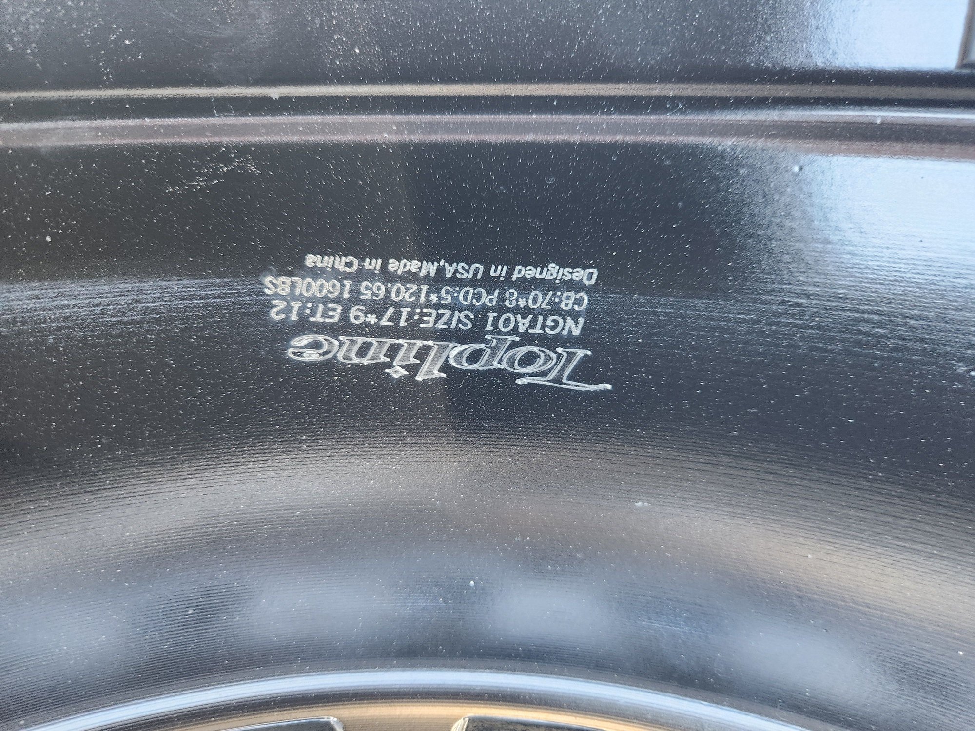

And here's a Hawks wheel, showing the 70.8mm spec stamped on the barrel.

-Hawks have a Topline stamp that is not present on the OER.

My guess is these are all coming out of the same factory, but with varied specifications based on who commissioned the production runs. Someone made the conscious decision to spec a lug seat and center bore that aren't a direct fit for a 3rd gen fbody - I suspect they were trying to adapt it to multiple applications, but won't pretend to know what those might be. OER's site calls out part numbers for lug nuts, so they seem to be aware that the seats are machined for a non-stock configuration. Side note for anyone that reads this and isn't clear on the difference, here's a visual.
The main purpose of my post was to call out that at least two different specs exist for these wheels, one of which is definitely not a direct swap for the originals on our cars. What looked like an opportunity to save a couple hundred bucks ended up biting me in the end, so my hope is that this saves someone from making the same mistake I did.
