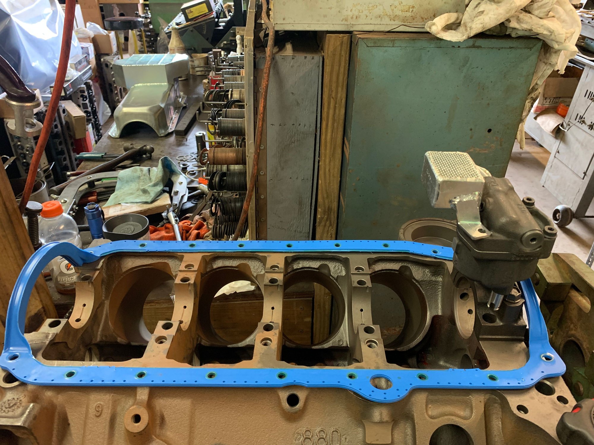

Old Aug 11, 2022 | 05:06 PM
Tombowman89's Avatar
Joined: Jul 2013
Posts: 179
Likes: 46
From: Green bow Ala-freakin-bama
Car: 88 Iroc
Engine: 388 Vortec Pro-Flo 4 Small Block
Axle/Gears: 3.77 to 1
Re: Canton Oil pan- do you have to use their pickup?
I bought both the road race pan and pick up and mated it to my melting shark tooth pump and still had to modify the bracket off of the pick up because there was little to nill clearance between pump and pan. I think it is true that the casting is taller in my case because the pump it especially bigger.
