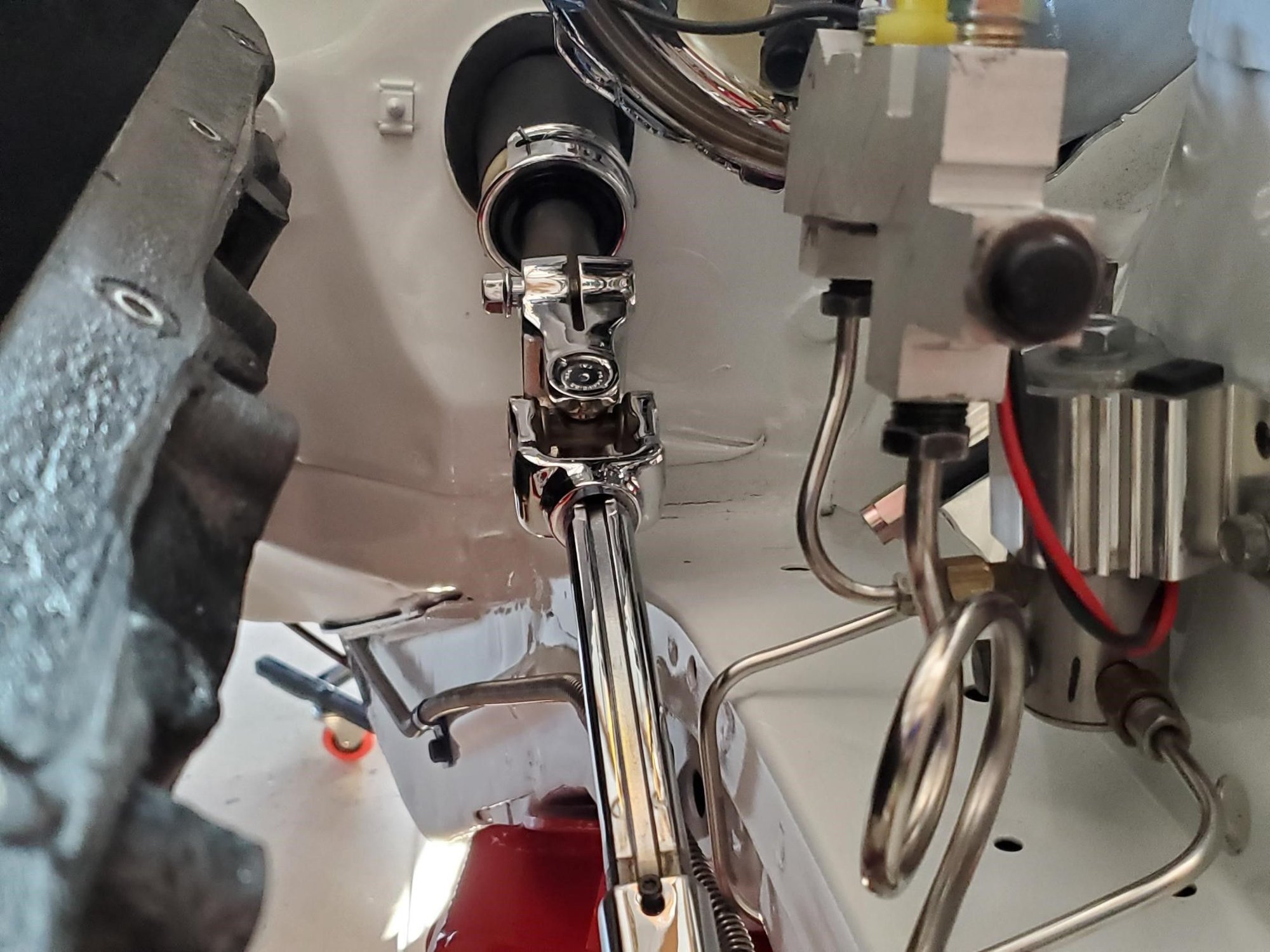

This thread began about 8 years ago, was last revived about 1 year ago, and I'm reviving it again now to describe a common problem with these bearings that most people probably have but don't know it, causing the bearing to function improperly, even though it might seem like it's functioning properly. Clear as mud? Good. And if people purchased these bearings in 4 pieces that need assembling, like it's commonly sold, then there's a good chance yours might be defective, and you probably don't know it.
Initially purchased mine from a vendor, who I won't name, because it's not the vendor's fault, and it came in 4 pieces to be assembled, which tends to be common from most vendors. After I assembled it, I noticed something that couldn't possibly be right, so I searched the net and found a video on YT by user, Suburban Ranch, where he addresses the problem, shows it in detail, he linked a steering business that confirmed it as a common defect, and he got a bearing from them that functions properly. So I contacted them, and I also purchased a properly functioning bearing.
gm, buick, cadillac, chevrolet, oldsmobile, & pontiac steering column housings and bearings 7805700 Brgkit60 lower bearing kit | Steering Column Services
My 37 year old original factory bushing was still solid, smooth and perfect with no slop whatsoever, so when I encountered the problem with the bearing, I almost didn't bother looking for a correctly made bearing. But since I had it all apart, it was now or never, so I did the search and found the problem and the answer.
When you snap the bearing assembly into the white bushing, the bearing race is supposed to fit so tightly that it will not move/spin inside the bushing. Yet it's common for the entire bearing assembly to spin inside the bushing, race and all, which defeats the point of having a bearing. No way that could be right, and it's not. The bushing and bearing race are supposed to be rock solid tight together, so that only the inner bearings that grip the column turns as the column turns. If your entire bearing assembly, race and all, is turning inside the bushing, then yours is defective.
What Steering Column Services will do, if you mention the situation, is preassemble the bearing assembly into the white bushing to confirm that the bearing race is tight and secure in the bushing and doesn't move, that only the inner bearing turns in the race, and then they'll ship it to you like that.
The problem lies in the manufacturing process of the white bushings. Sometimes they'll shrink ever so slightly immediately after the manufacturing process, leaving the inner surface of the bushing a hair too large for the bearing assembly, so that when the bearing assembly is installed into the bushing, the entire assembly is loose and spins inside the bushing, which it's not supposed to do. So if any of you found that the bearing assembly popped into the bushing easily, then it's probably loose in there, and it shouldn't be. The bearing assembly should be a ***** to install into the bushing, so that the only thing that spins is the inner bearings in the race, not the entire bearing assembly.
The entire assembly spinning in the bushing will probably be slightly "clunky" and could become "clunkier" as the bushing wears due to the looseness of the bearing assembly in it. It's something you might not notice during driving, early on, but if you were to grab the column and try to move it up and down, you'll probably be able to very slightly, but enough to feel and hear it lightly "clunk." But that's not supposed to happen; you shouldn't be able to move it. I suspect most of you popped the bearing assembly into the bushing, may or may not have noticed a slightly loose fit, but thought it was good to go, and away you went, with everything seeming to be working fine, when it really wasn't fine.
I'd suggest y'all pop your hoods, start the car, have someone turn the wheels back and forth, while you watch the bearing carefully. If the entire assembly is turning inside the bushing, not just the inner bearings, which won't be easy to see with everything installed, then the white bushing is defective. Or for those of you who have the new bearing but haven't installed it yet, pop that bearing assembly into the white bushing, and if the entire bearing assembly spins in the bushing, not just the inner bearings, then yours is defective, and it'll be good that you learned that now before installing it. If so, then I'd suggest you return it to where you purchased it and contact Steering Column Services for one that's preassembled and confirmed tight.
Man, that was long! And probably very redundant. But I wasn't sure how to say it simply, one way, so I said it in multiple ways lol. Sorry!

1 step Beyond..

I installed the Borgesson#000315 steering shaft along with the Wolff M109SS back in October and they were both a very easy install. The only issue I had with the steering bearing was getting the last set screw tightened on the collar. It is in a weird position and does not spin with the inner shaft. If I had smaller hands, that would have saved a lot of time and cuts. Both units are nice, but the Wolff M109SS is well engineered and fit perfectly. I was having two issues, one with a slight clunk when the steering wheel was turned a few degrees. The second was a tiny bit of play in the steering. After installing these units, those problems are gone.
Thank you for the review! I plan on getting and installing both these that you mentioned the steering shaft along with the wolff bearing. Did you use your stock steering box as well?

Yes, the stock steering box was used. The car only has 33,000 miles on it, which I know is not an indicator of wear, but the steering box is not a problem. One thing to keep in mind with the steering shaft is, you can turn the steering wheel to manipulate the position of the screws and nuts that need to be tightened on it. Just a simple thing to remember, but it will make the installation so much quicker.

I did the Wolfe Bearing over the weekend, I had to pull the Borgenson shaft that I had in there out to clean it up and paint it. That's something I highly recommend, because it will surface rust. The Wolfe bearing is nice, but like stated the bottom set screw on the plastic collar is a pain. Everyone installing these are in K5s or other trucks, so much more room. Our cars not so much with the booster right there. The design is a bit overkill, because the set screws on the bearing to hold it in place, then you have to bend the tabs/fingers over it to be perfectly flush, that's essentially also locking it in place to where it cant go any where. If the tabs aren't flush, plastic collar wont slide on. But the collar essentially acts as a third method of retention.
