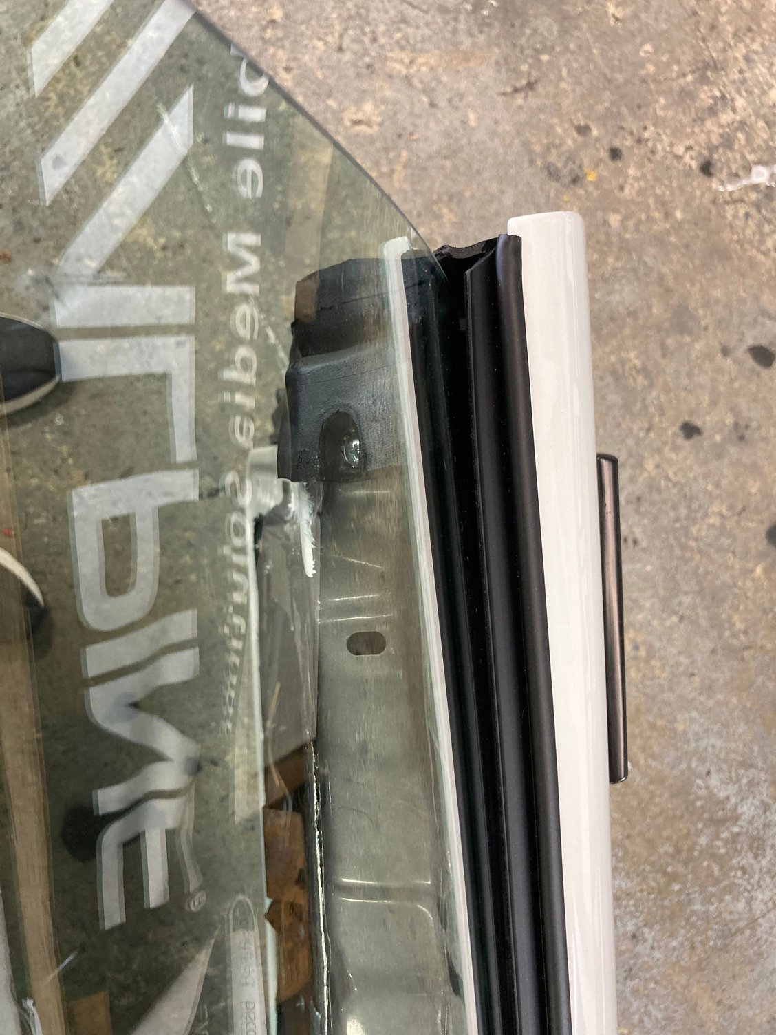

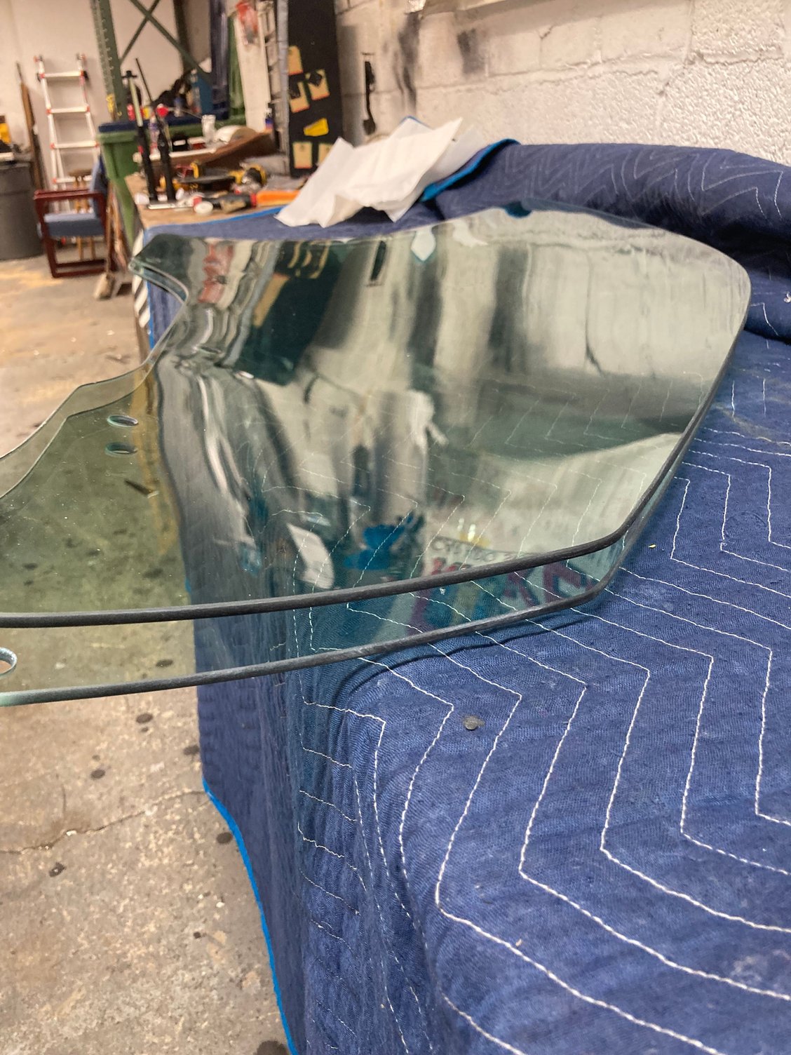

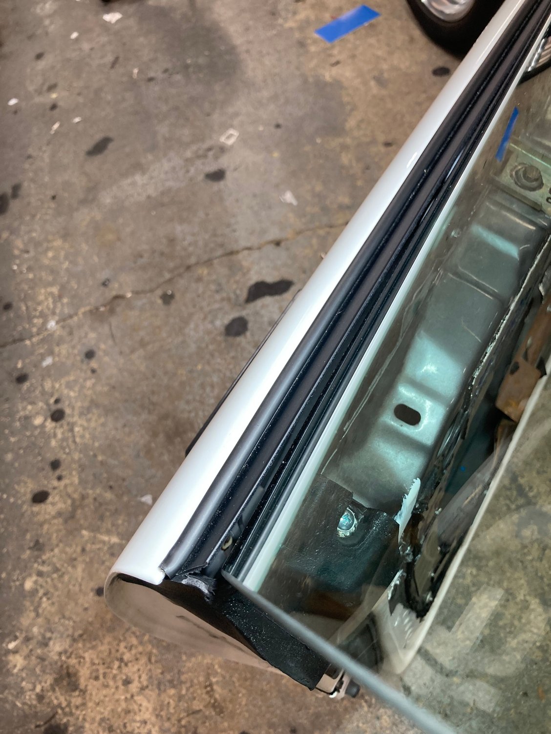

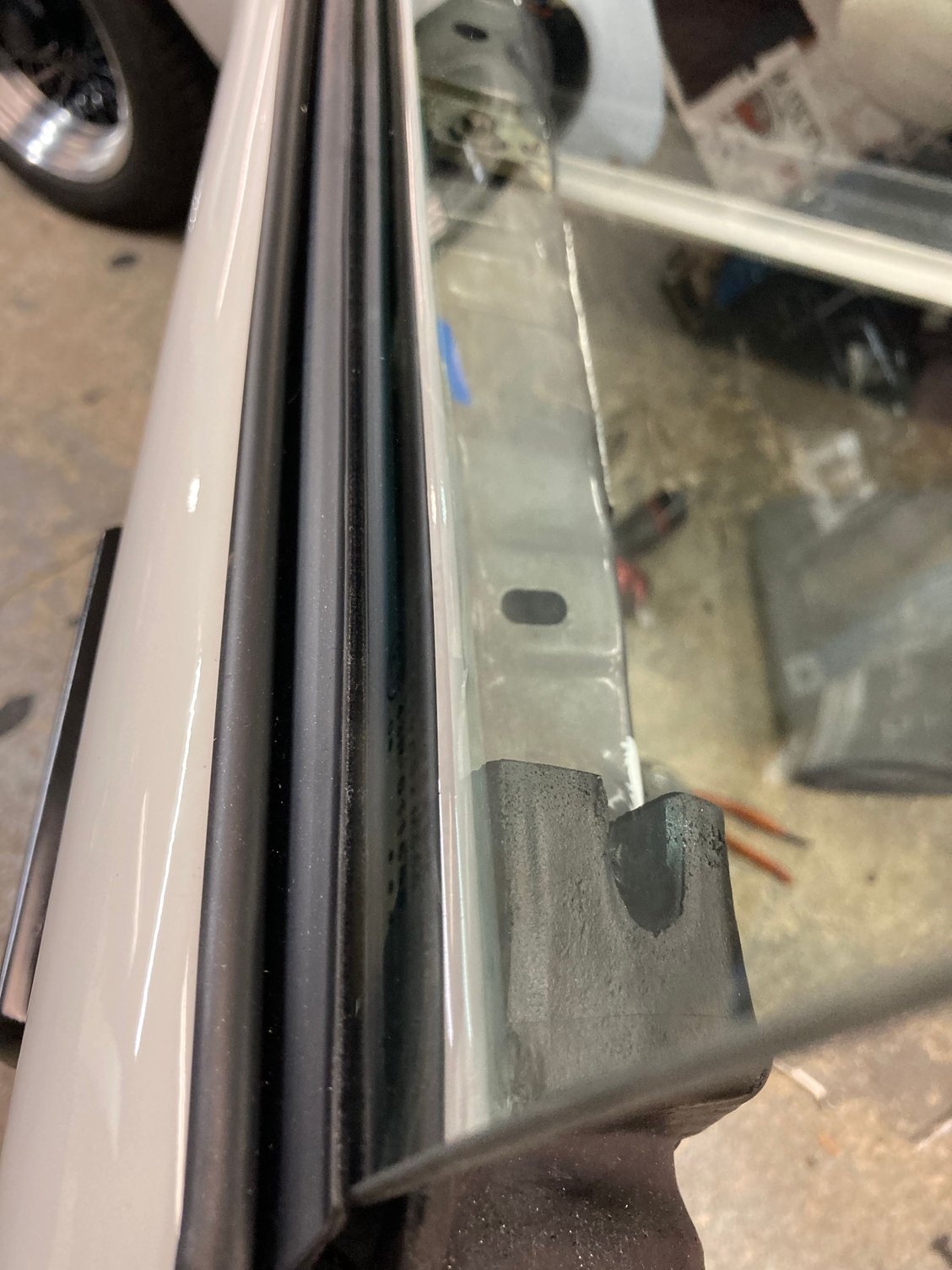

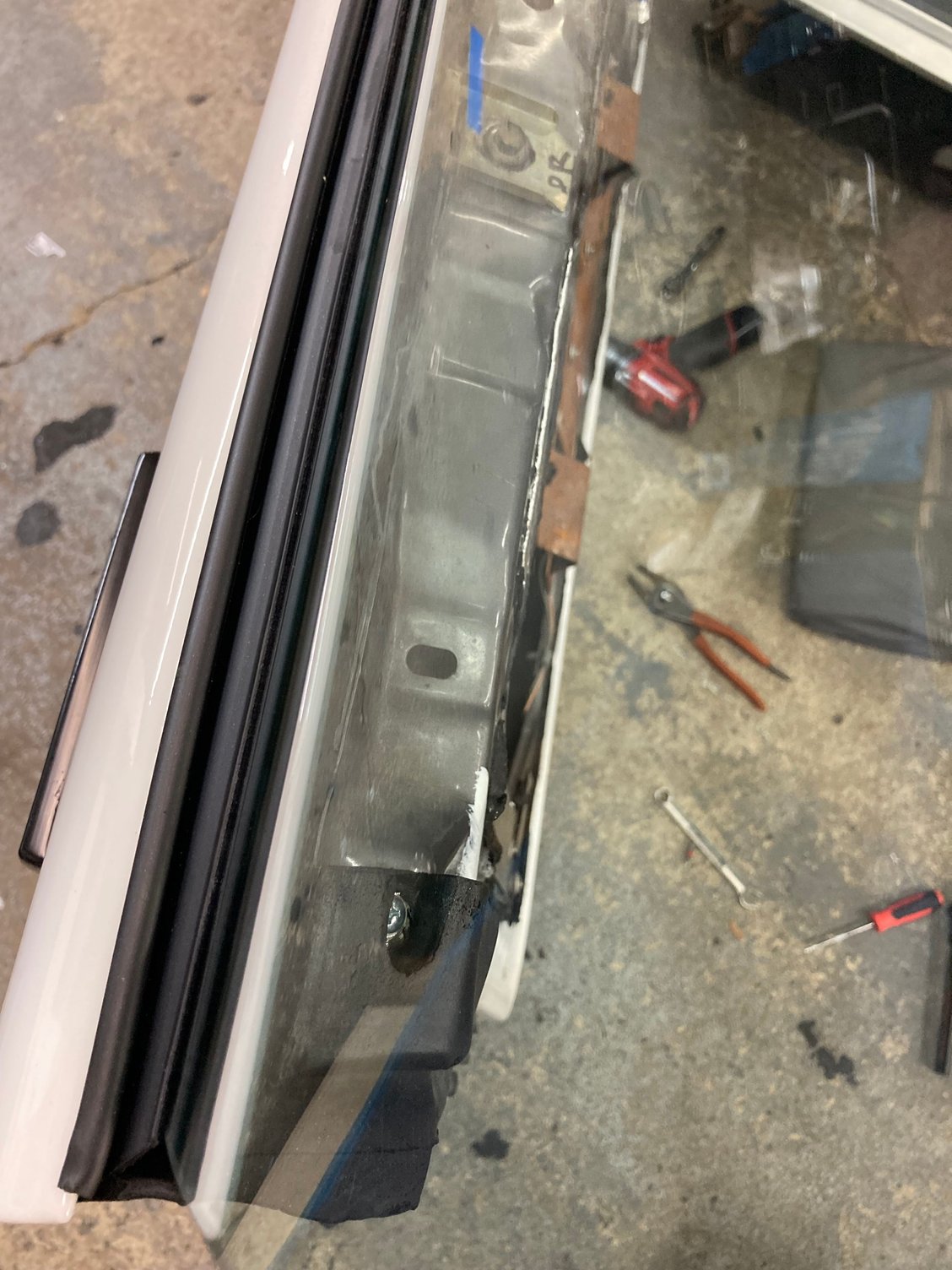

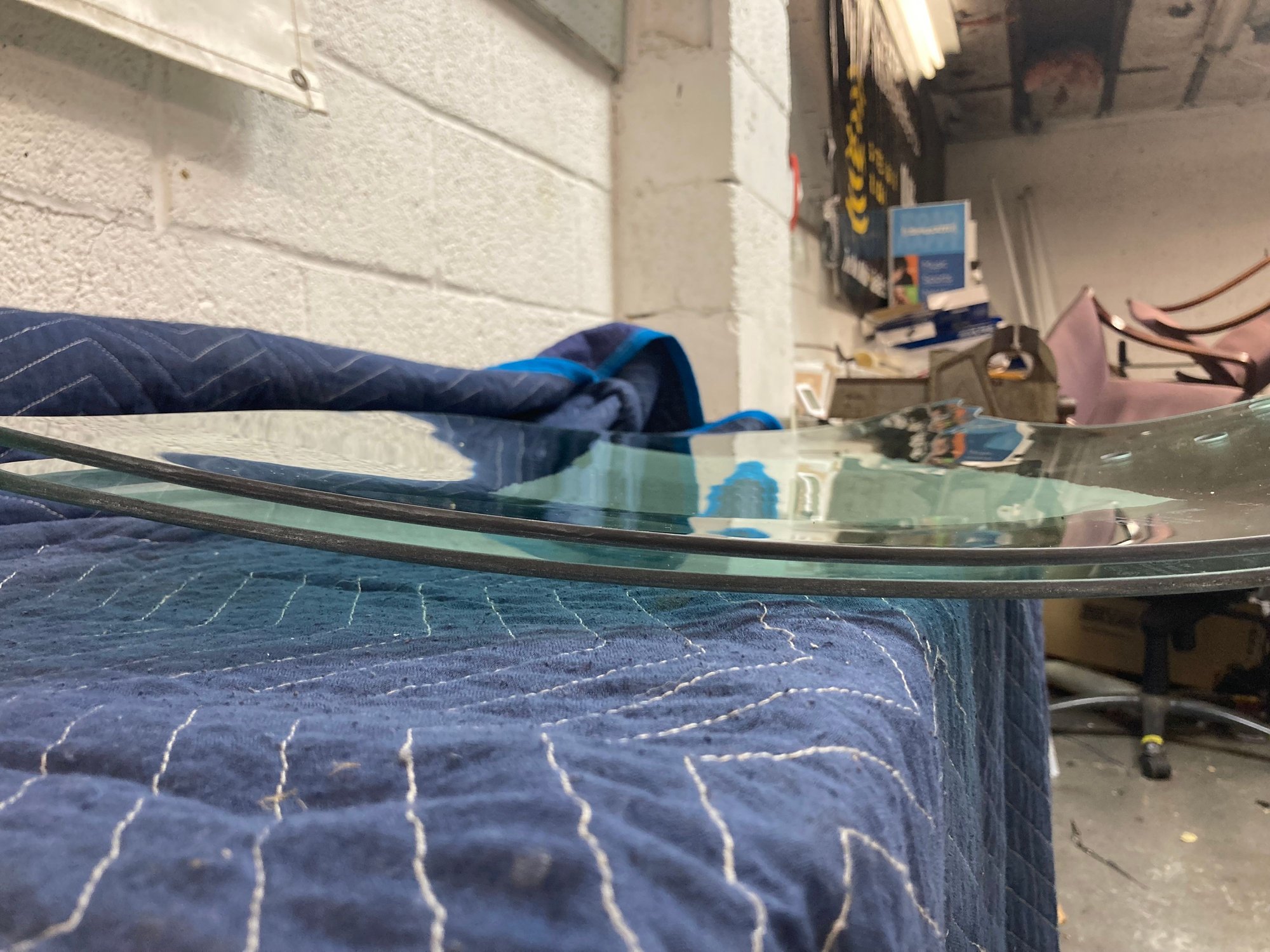

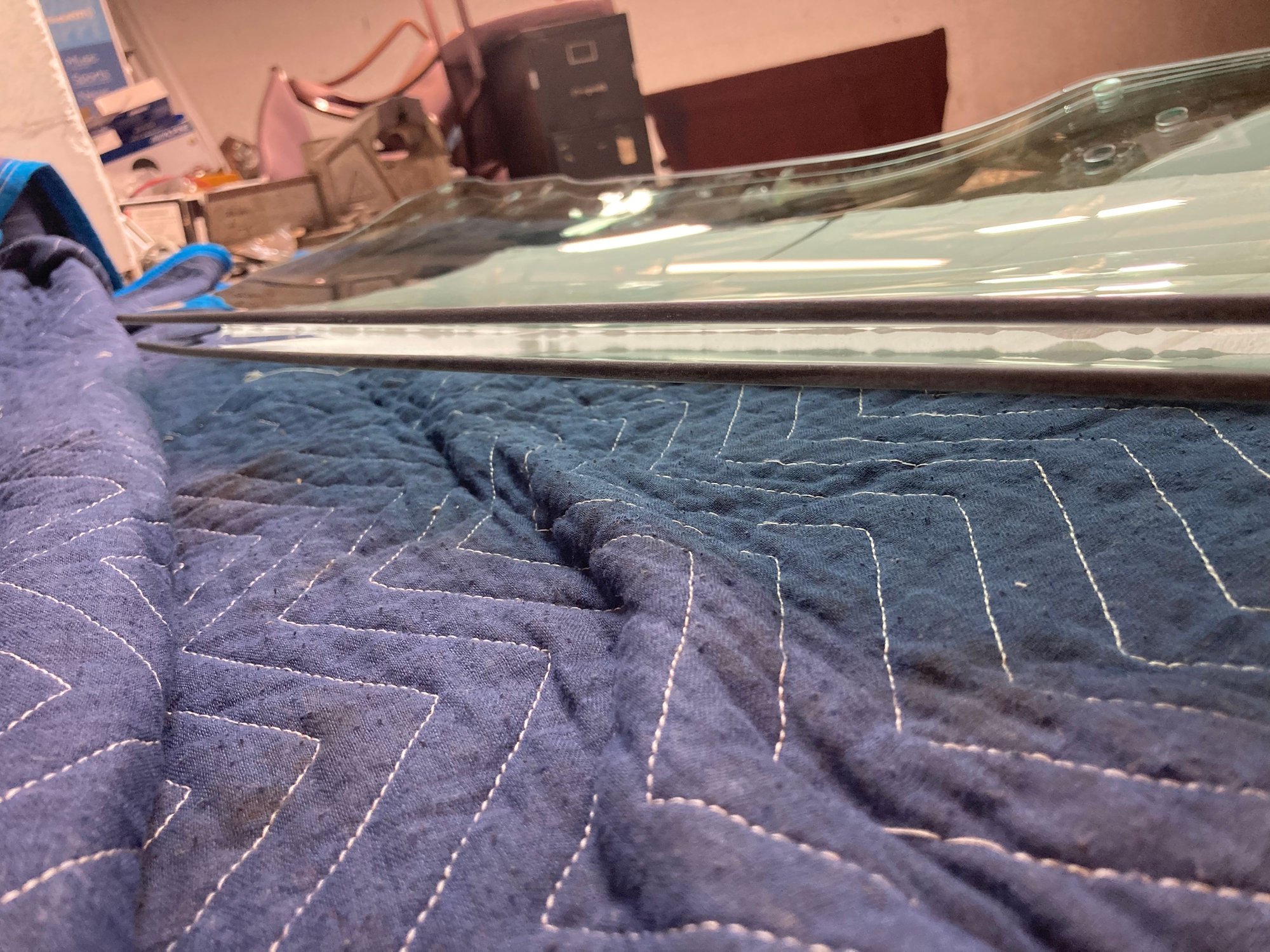

Glass saga resolved. Thank God! Arrived today at about 3PM, was very anxious to check/install these so I did them right after I got off work. Sized them up first against the old glass, then against the 90-92 style glass. Absolutely 1000 percent molding error/defect on the 90-92 glass. Curve was nearly dead-on for the 82-89 version against my old glass. Installed, they look and work great..no more binding!! Very happy. A few pics..

Yes..I would say that is very similar to what I was dealing with. You can see in some of the pictures I posted, I have the glass that came out laying under the new glass. The curvature was quite extreme and out of spec. When I received the replacements (82-89 style), prior to installing I laid the new glass over the original from the car and it was nearly a perfect match..laid right on it with nearly any gap at all..so I knew it would fit. The 90-92 style I had originally received was way off!!
