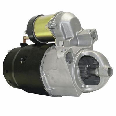

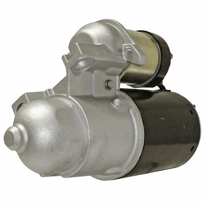

Re: High Torque Mini Starter from rarelelctrical.com
Originally Posted by raynehr
Why not?
The end cap (dome) on an Auto starter is bigger than the others. No Idea why they had to be different but the auto one will not work in a manual bell housing.
Auto
Manual
Auto
Manual
Ok, this thing is a mini starter, and I can tell you from pulling my big clunky one off, that the bell on the new MINI starter is MUCH smaller than the bell on the old clunky 30lb piece.

I got the exact same starter as the OP. Just put it in. Sounds, ummmm, different. We shall see.
that's what I have
