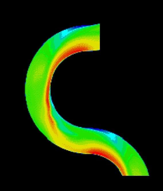

As long as other folks are resurrecting this thread...
WAAAY back towards the beginning of this thread there was some discussion on whether the the center of the runners could be ported without cutting into the runners. -I'm not clear on what the answer was...
One of the limitations/weaknesses of TPI runners including the FIRST runners is that you are trying to get air to make 180 degree turn and it REALLY just can't do it well at high velocities. (See attached CFD drawing from a Porsche intake with a similar shape.)
--What helps air make such an intense turn in direction is to increase the area at the point of maximum velocity (increase the area around the apex of the turn so that the velocity slows there and more of the runner area gets used) ---being able to open up that apex is really useful...
Has anyone tried or considered using something like a 1 7/8" (1.875") Flex Hone with aluminum oxide @ say 40 grit to try and open up the center of the runners? This would be the BC series Flexhones; they have a length of only 8", but it's dead simple to just use an old pushrod length checker and some JB weld and extend the length. -The flex hone is kind flexible and would naturally move more of the outside of the runner curve than the inside, which is really what you want anyway to help the air make the turn. You could follow up with 120 grit to end up with a smoother finish...
Related thread after I asked how to get the air to better make the 180deg turn in a TPI intake on SpeedTalk: https://www.speed-talk.com/forum/viewtopic.php?t=63458
