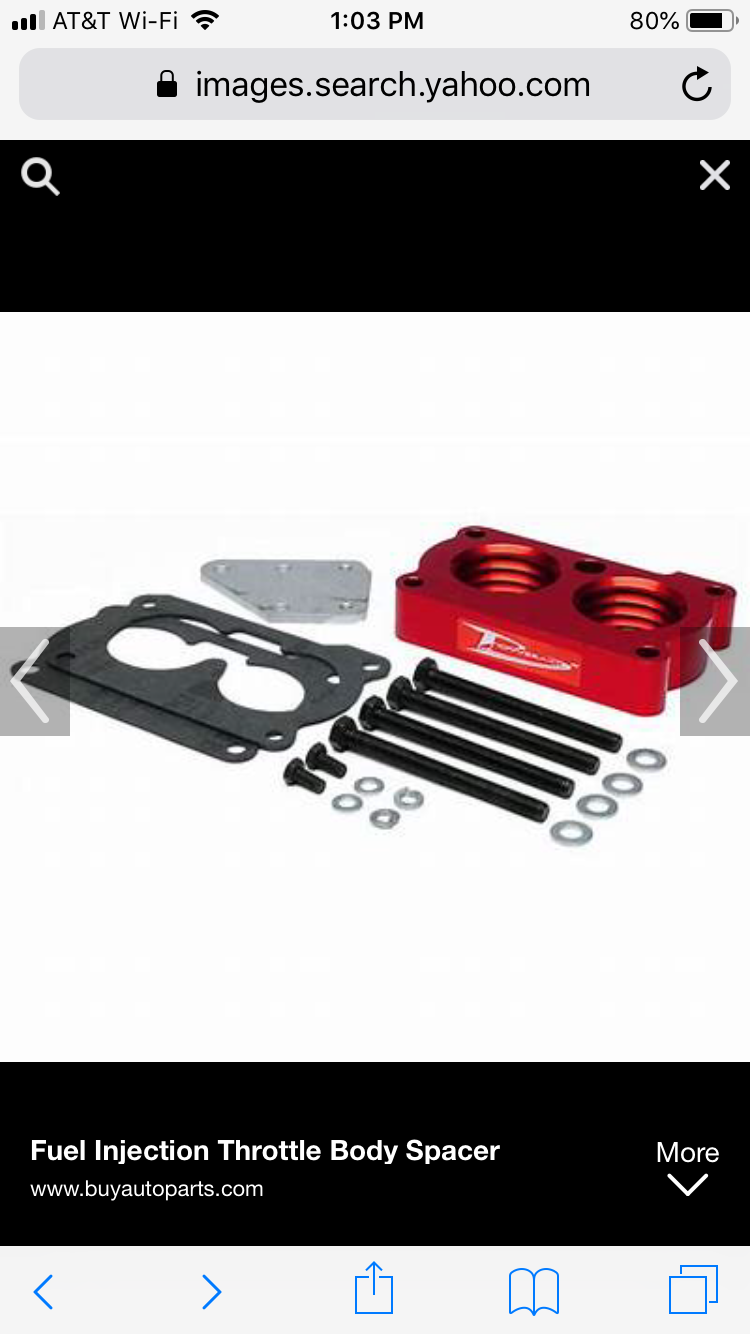

I’ve seen the addition of a spacer like air raid it move tb mount fwd. another alternative since 89-92 throttle cable bracket hits is try to screw in crossover 90 more or use the 85-88 tb and change throttle cable unfortunately.
