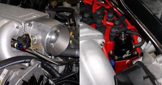

I've always been partial to Aeromotive myself, particularly the big A1000. I used it for both the HSR and FIRST install. Picture below is of the older fuel rails (crossovers up front and rear) - I ran the feed up front and the return out the back..

Is that a small cap dizzy?

Yes. The large cap will work with the FIRST but you have to grind on the bottom of the distributor housing. I had bought the small cap distributor for the StealthRam and reused it when I installed the FIRST. Worked out well for me allowing room for the big regulator mounted directly to the rail using a coupler..
