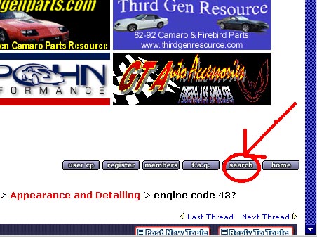

Originally posted by redbird_400
No but I can find out.
>anyone who says search has to give me a dollar!!!!!
I didn't say a word.
