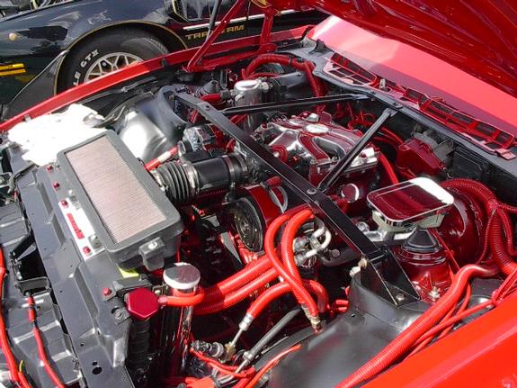

I'll agree with the previous posters in that it is easier to paint an engine compartment with the engine out, but you CAN do a good job with it in if you remove the battery, coolant/washer jugs, etc, and carefully mask the rest. Aluminum foil works very well for oddly shaped items that are hard to mask. Wrap the engine in plastic to protect it. As long as you get the surface clean, sand it adequately, and use a decent quality paint in a relatively warm (70 deg is ideal), dry area you can get a good job. It will never be as nice as an engine compartment that is painted (body color) and cleared with a gun, but it can be passable until you have to pull the engine and can redo it. Its definitely better than a dull and chipped original paint, or a poorly done repaint. This method is getting by until the engine comes out, then it will be repainted.
