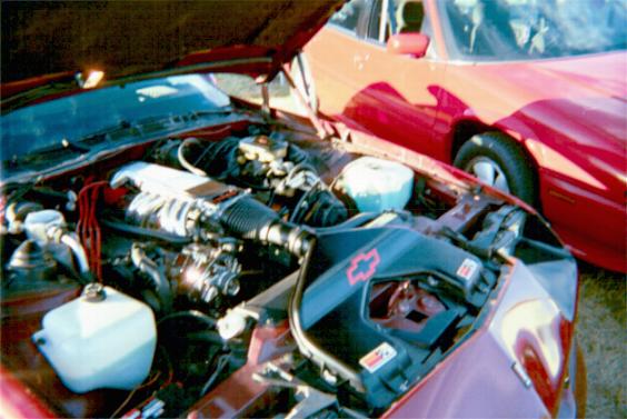

i don't have polished, but i will tell you that if you plan to powder coat or chrome plate anything polishing makes all the difference. most of this is ceramic coated; soon to be polished and chrome plated if i can't sell the pieces.

Kandied.......about your car... did it have the dual intake thing, and you just put a cold air induction on it or what. im really curious cause that looks really cool.
Old Nov 13, 2002 | 07:31 PM
Kandied91z's Avatar
Joined: Nov 2000
Posts: 13,039
From: michigan
had the stock intake setup, i used a cover that is commonly found on the carbed models and custom fabed up a CAI (cold air induction)
thanks for the compliment!
aren't you in michigan, could have one built for you. i'm selling mine although i doubt you want to spend 200 bucks on an CAI even though it does work extremely well and makes the car sound like it's supercharged when it's running.
