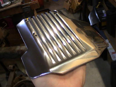

no your 100% right. For some odd reason GM decided to give the camaro's and firebirds plastics ones....VS ones that came with the vettes were alluminum. So alot of people on here including myself have ordered the alluminum ones. Mid America sells them....so doesnt corvette central. To pass the little tip along though....make sure you get the screws with it also. 3 star head screws....cause the ones that came with 3rdgens wont work with an alluminum TPI extension. I believe everything cost me bout 40 bucks...so its not that bad. I got mine in and polished it by hand.....took me bout 4 hours. Well worth it. Here are some pics. Hope this helps.
