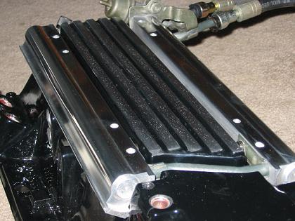

Here is my LT1 intake. In this pic, you can see the pits, all 550,000 of them
But it looks fine from 5 feet away, so rather than make them worse, I just stopped sanding.

The pits are more commonly reffered as {gas} usually it gets worse as you sand. I think parts that are pourn during cold weather have a greater chance of getting gas.
