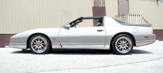

who's car is this?
i know there was a post along time ago trying to find out, but i can't find it...
trying to find the specs on the wheels if anyone might know?

Those wheels are Coddington Rodder wheels....they are 18x8.5 in front, and 18x9.5 in the rear.....as for backspacing....cant help ya there,

i once new the owner as he does post on here occasionally, however i've lost his name and his email. doesn't anyone know or have a more detailed article possibly?
how do you know the size? i'm not positive but on boyd's website they can only be ordered in full measurements so it would be 8,9,10, etc.
8 is way to skinny so i was thinking around a 18x9 front and 18x10 rear if i were to go with those. although i really like that exact look so i would like to know the exact size.

I know that those are the wheel sizes because it says so in the winter 2002 Camaro Performers magazine.......that picture you posted is the article that I got the info on it....the magazine is sitting in front of me because that is one of my favorite third gens. I dont know if they are the correct sizes, but thats what it says in the article of the magazine.

i can tell you everything about those wheels as i am buying them this summer
they are the boyd coddington rodder 5s...
they will fit our cars with NO MODIFICATION whatsoever, or at least all the offsets i've seen for sale will...

You can order any size width you want (even 13" wide!). They also custom make the offset and backspacing to your liking, so its possible to get a perfect bolt on fit nomatter what size wheel you want. My Boyds are the Tuned series 18x8 front with 4.5 backspacing and 18x9.5 rear with 5.5 backspacing. Returned the original tires I bought (defect), getting ready to order a different set. Anyway, will be 245's in front and 275's in the rear. I could have gone with wider wheels, but I went with these sizes because I want the wheels to tuck the fenderwells when the car is slammed. Daily drive height will be a 1.8" drop front/rear, but for shows/pics it will be dropped 3" front/rear (Slammed!).

does it give any info on the suspension specs. also, what tire and profile are they using.....
i'd like to get ahold of that issue just so i could read it. i love the look of the car along with the stance.
boyd says on their website that they only make them in full numbers, if they made them in halves that would be great as a 8.5 is much better then a 8.

as for the suspension on the car, it has BBK lower trailing arms, lingenfelter adjustable panhard bar, Suspension Techniques spindles, and 2 1/4 inch lowering springs with tokico shocks.
As for tires, He is running Sumitomo 234/40s on the front, and 235/35s on the rear....hope this helps some.

thanks, i'm puzzled though because boyd says they haven't and won't make them in half sizes.....
a 234 seems like an odd number, you sure it isn't a 235 on the front.
a 235 35 on the rear seems way to narrow for a 9.5 rim you sure it isn't a 275 or at least 265???
i'm not doubting you but the information is very different. do you have the name of the date, issue no. so i could write the mag and ask them myself???

yeah my fault is was a 235 i hit the wrong key
everything that i put came straight from the article, and I thought it seemed alittle odd myself.
as for the issue all it says is the winter 2002 Camaro Performers, which is operated by superchevy.....the name of the article is
FROM FATHER TO SON.. again hope the info helps, but that is the best i can do

they must have gotten it wrong....it's probably a 8" front 9" rear combo as they don't make half sets...in fact most billet companies don't really make a half width rim for some reason?

Who from Boyd told you they dont make 1/2 sizes? I think they are giving you bad info. Boyd made my rear wheels 18x9.5. For the fronts, I could have gone with 18x8.5 or even 18x9 but I wanted to stick as close to OEM as possible (width wise) so I went with 18x8. When you choose the width of your aftermarket wheels, keep your suspension setup in mind. If the car will be low enough for the rim to tuck the fender (like on my car) then you might want to think twice about going extra wide. Going extra wide will prevent your car from being slammed really low because the tire starts to contact parts of the inner fenderwell. You can do inner fenderwell modifications to accomidate wider wheels, but its all up to how much work you want to do (or how much you want to spend). Because I plan to slam my car 3+" for shows, I went with sizes that would allow maximum tucking (purely for looks). If you dont plan to go that extreme you can run wider wheels and it will be fine. I wouldn't consider it impossible to run 18x9.5 front and 18x11 rears because other people have run the same widths, just with 17's instead of 18's. Definately would require alot of research for the perfect fit, but its possible. I couldnt justify going through all that trouble because my car is a street car and I dont need super wide wheels to drive around. I'm just interested in the perfect stance with the rim tucking under the fender (front/rear). Revlimit has the best example I've seen yet of (what I consider) the perfect stance but I dont have any pics. His car is SLAMMED!!!

That pic came from my webspace somehow... I think easyspeed punked it. I scanned it from a mag with the article that was mentioned "From Father to Son" I originally scanned it to ask Easyspeed if I should go with those wheels and the focker stole my idea
