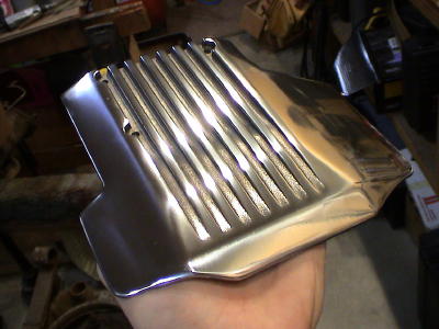

No. The original distributor cover is plastic. You have to go to GM and order p/n 10108425. You will also have to order the 3 screws which go with it, as the old screws will not work. Each screw is p/n 14082425. Once you get it, then you have to polish.
And yes, you can get that shine from the stock plenum. Like I said in my above post, do a search in this board, with my username and the word "polish" or "plenum" and you will find a lot of stuff as I have taken part in many polishing threads.
