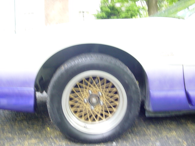

Old May 14, 2004 | 03:25 PM
badapple's Avatar
Joined: Apr 2004
Posts: 63
From: West Virginia
Car: 1987 GTA
This one is a bit blury, mods can delete if needed but this really shows the gap.
Old May 14, 2004 | 04:01 PM
nolanr0413's Avatar
Posts: 2,790
From: New York
Car: Trans am
the back sits right but the front is deffy f ucked up .
