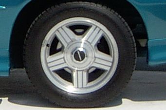

I am polishing my wheels. I just saw that eastwood put their polish in tubes and though that it may have been a paste.
The types of compounds I have are: Emery, White Tripoli and Rouge. I was going to use all three after wet sanding with 400 as layed out by one of the links that is in the post stickied on this forum.

Forgot to attach the pic of the wheels

Should look nice when done... I love mine.

Hey Chris, look great, hey remember me? I bought the 9-bolt off ya?
Anyways those look awesome, any hints or tips on these wheels? Especially on the inner triangle part? I am sanding there and am getting a lot of pits. Also how did you sand? palm sander hand, mouse etc
