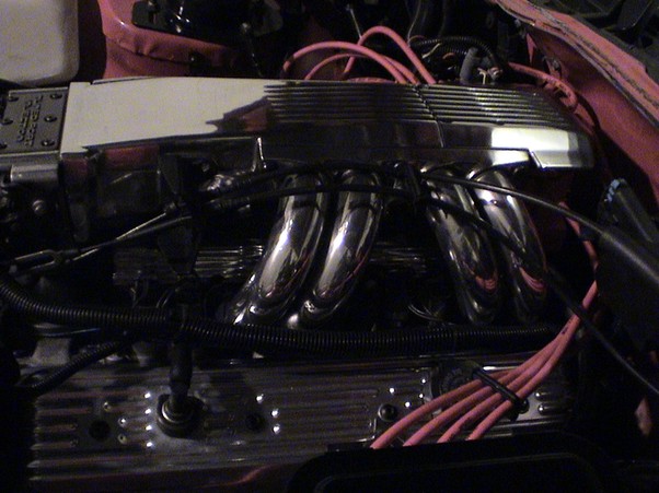

I had nothing to do all winter so i figured that i should polish my plenum, runners, plenum extension, throttle body, A/C delete pulley, alternator, belt tensioner, radiator cap, 4 rims and a fuel rail... .....
I have spend many hours polishing but in the end the results are unbelievable..and i think i need to see a chiropractor from leaning down so much..
I have used this polishing compound and i am attaching few pics...
Too bad my camera is not so good..
Let me know what you guys think..

Wow ! looks great -- it'd be a shame to do all that work and not let us enjoy it.

VERY NICE.

Looks great man. I see your brackets and alternator are done too.
Nothing beats polished TPI

Looks great! Did you do all of that with it on the car?
Thanks guys.
I took every single piece out of the car and polished it in my basement. I don't drive it in the winter so the car stays in the garage..
I have sanded each piece down and then polished it using that compound and an electric drill with a buffing wheel.

I have estimated that adding all the hours spend on removing, preping/sanding, polishing, installation it came to approx 65 hours of pure hard work..
The hardest pieces were the rims (taking clearcoat off + lots of sanding), runners, alt ( lots of turns, corners, hard to get areas).
Other pieces were not too bad.
Novass, your engine bay look beautiful as well.
Godspeed, all of the parts mentioned looked like dull silver but after some work you can make them look like chrome...It is really amazing.. My wife still can't believe the before and after difference...
As for some direction everybody has a different way..
Basically, i had to remove each piece from the car and did this:
1. dremel sanding roll 120 gritt (small role) to remove all bumps, uneven surfaces and that stupid grain /
2. sanding paper 180 ( on a palm sander - if the area was nice and flat like the plenum and extention) , 220,320, 600, 800, 1000 (all dry)
3. washed each piece brfore going up to the next grit
4. polished using the electric drill and a 6 inch buffing wheel + compund ( some very hard to reach areas i used the small dremal buffing whell )
5. used couple of my old soft t-shirts to ( not on the pic ) to rub the black sooth off each part after polishing
I have used the automotive paint stripper to removing clear coat from the rims then i just used the sand paper mentioned above + 1500 and 2000 grit..(rims i did wet)
I think that's is it for the supplies.. I don't even know why i did all this work because i will be selling this car in few months (will become a dad in few weeks and i need a nice 4 door family car).
Or well, at least i had fan this winter..
