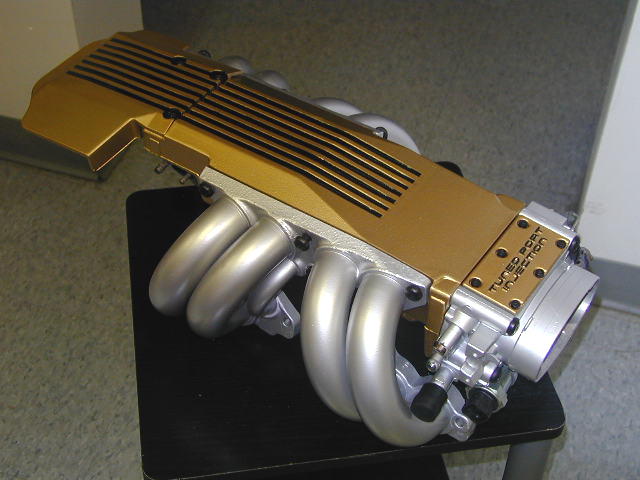

Travis,
take a look at this pic of my TPI, its the same paint im going to paint my gold rims with....I used Duplicolor Heat paint, even the clear is Heat paint...Ive used it before and it holds up great...just lightly sand, tape off what you want then paint it, use several coats of gold till you get the shade you want then use several coats of clear.....show some pics when your done, when mine are finished ill post some too.....

whats the part number to that? the official paint code gm used is 92P. is thier maybe a cross reference a paint store could tell me? i worked on my rims just now today, pretty much stripped of all color as of now.
Old Mar 30, 2005 | 08:10 PM
Bombero's Avatar
Joined: Mar 2005
Posts: 44
From: Florida
Car: 1986 IROC T-Topz Black/Black w/Gold Decals/Rims & Badges
Engine: 305 TPI stock
The gold is: DE 1604 Universal Gold
The clear is: DE 1636 Clear
Its the engine high heat enamel with ceramic 500 to 1200 degrees
you can get it at : Advance Auto, AutoZone,NAPA or even WalMart.
The gold is so close you cant tell the difference....

from what I've used so far I would say 3 of the Gold and 2 of the Clear, they are 5 bucks a can. Just make sure you paint them on a warm day, I painted my parts outside in the sun and the paint laid down and blended real nice, it also stayed tacky enough so when it came time to clear it, sprayed nice and even (no "zebra" stripes or overspray lines)
