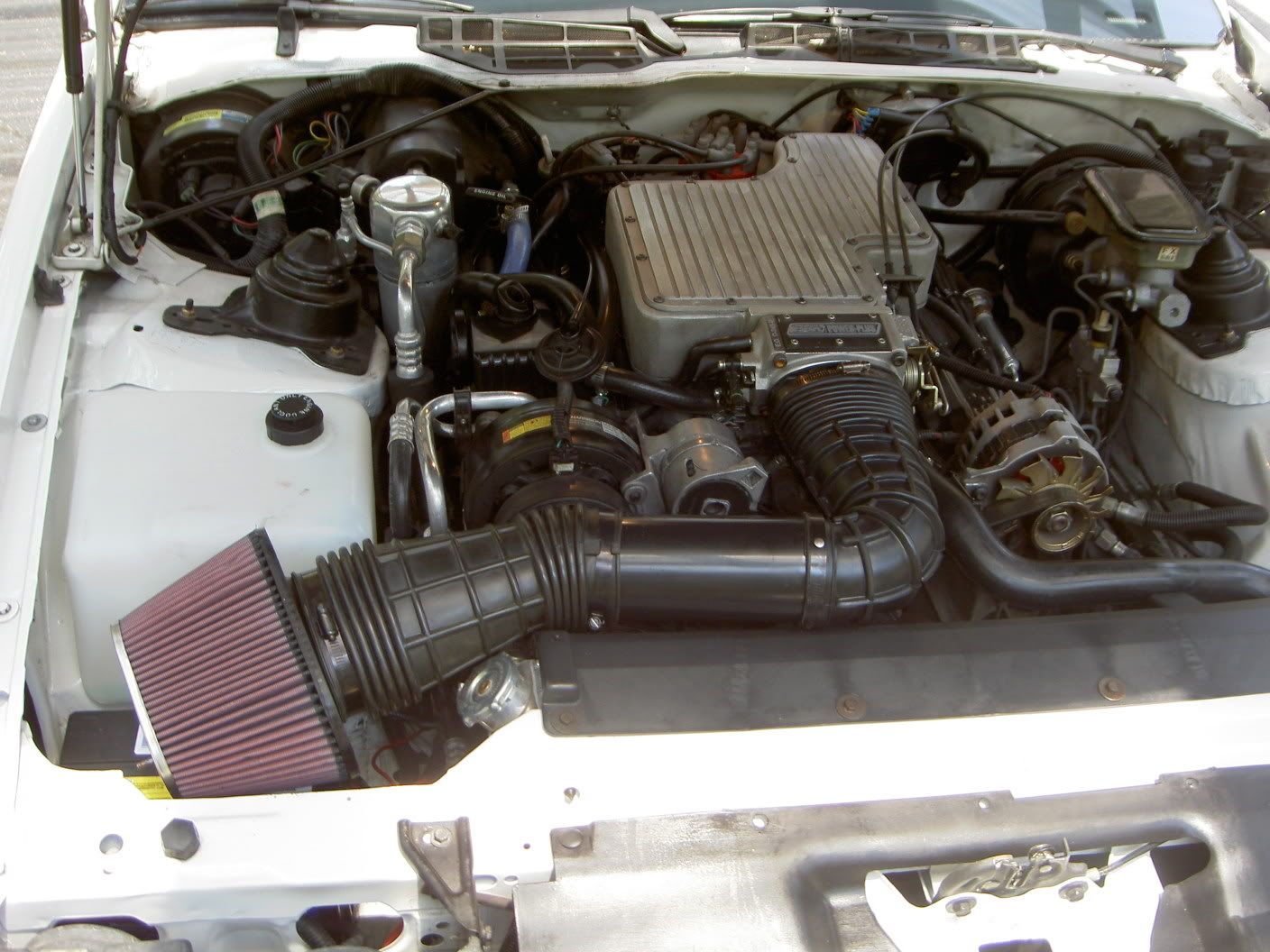

Here is a picture of my custom cold air intake I just made and some other pics of my car. Tell me if u think the cold air intake looks cheesy or looks good.

I guess it's OK, but why don't you put the filter right on the intake instead of running it around "Firebird TPI" style? The air has to go through a maze before it gets anywhere.
The air has to take about 5 turns before it gets to my engine on my Trans Am. That's one thing I always liked more about Camaro's ... it's a straight shot to the engine on the TPI's. That's why the 305 TPI Camaros have a few more horses than the 305 TPI Firebirds.
[edit] I just looked at your pics again and it doesn't look like you have room for what I suggested. Never mind. Good work.

Putting the filter right on the throttle body wouldn't be a cold air intake because it would just be sucking up hot air.
Cold air is more dense and makes more horsepower... the two turns his intake has in it aren't a big deal because the air the comes in by the headlights is much cooler than the underhood air.

Yeah....Pulling in underhood air certainly doesn't qualify as cold air. With an air dam, it might get closer, but that still barely qualifies in my book.

I think it would be cold air if you ran it into the fender. Looks god though.

I get the feeling that a gutted stock TPI air box would fetch you more power than what you have. I could be wrong, but it's a good possibility.

exactly. it looks cool, but it doesnt perform as well.

Well i couldn't put the air filter right off the throttle body anyways because i am running a 1000cfm oval filter that is made for the big blocks but since my cfm is pretty close to that, that is why i am running that. This intake was fairly cheap plus i didnt want to run the battery to the back of the car. thanks for all the advice though!

Honestly, I think its heading more towards the cheesy side. I would either route the filter down into the fender (note: get rid of the ribbed piece directly connected to the filter) or get one of the stock thirdgen intakes.

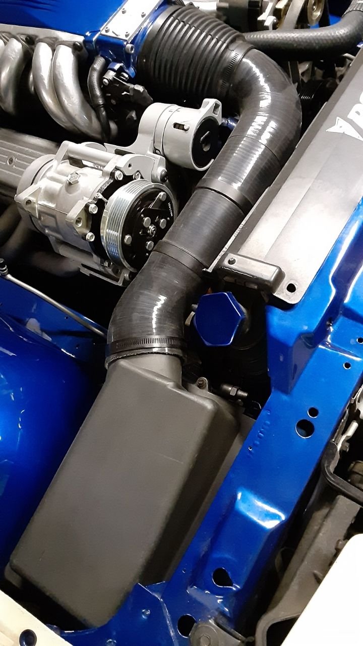

I made mine using silicone tubing and a 90's lumina airbox

If you ask me that kinda looks cool. Clean and like a factory appearance even 👍🏻

Thanks CK, that's actually been a goal to make most any mods I've done to my pos look factory-ish (at least to those who aren't Drew level).
Being an 87, it is a MAF car and the MAf is in between the clamps of the not quite factory A/C compressor that doesn't look fully out of place..
