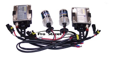

HID conversion done!!

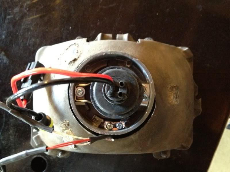

So I got this fairly inexpensive HID conversion kit from eBay http://www.ebay.com/itm/4pc-H4656-H4...item2574137923
They and my headlight buckets did require some modifications to fit, I will include them as well as pictures.

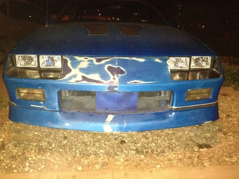

Gonna try this a little different. Before.

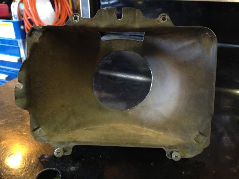

For these HID's to fit the headlight buckets...
You will need to remove the tabs shown in the pic above, I used an angle grinder with a cut off wheel and then a file to smooth out the edges. It should look something like ths when done.

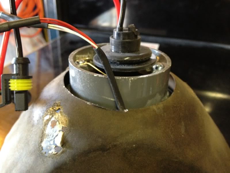

There are also four tabs on the back of the new light housings that I needed to trim shorter for the outer bezel to mate up to the bucket properly. I used the side of the wheel on my bench grinder since the back of the housings are composite and not glass you shouldn't have to worry about breakng them, unless you drop them. Unfortunately in my haste I didn't get any pics of that. Also, if you get the same HALO kit that I got you will need to protect the HALO wires, I used heat shrink tube because it is thinner than split loom. Its also a good idea to extend them before you install the lights.

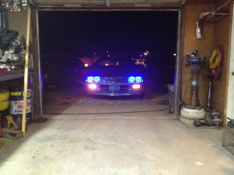

I connected my HALO's to my parking lights but you could connect them to a switch or whatever, the parking light harness runs right behind the headlights and is a brown wire. I used double sided tape and zip ties to mount the ballasts between the two openings in the body behind the head lights, DON'T TRUST ONLY DOUBLE SIDED TAPE!! My ballasts fell off and almost got ripped off. I wired both the high and low on the xenon bulbs to come on when the highs are on because the HID's are off in high. Last but not least the finished project, I also got the stock fog lights installed (maybe HID's for them soon).

So there is a parking light mode, where theyre just dim and blue? I like that. Its not unlike the DRL's they use today.

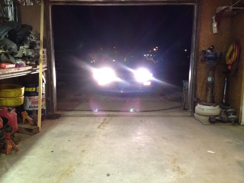

That first thumbnail with the lights up against the garage door is a huge difference from the last picture taken the same way.

The dim blue is the HALO, they are rings of LED's around the outside of the light that are controlled by the red and white wires with the shrink tube.

Wow those look really good. I like the halo ring when just the parking lights are on, that's sexxy. Great pictures and thanks for sharing.

Just FYI, never drive around with just your parking lights on, you will get pulled over/ticketed.

I wondered about that so I made it easy to disconnect the HALO's. Thanks for the heads up.
This is the perfect image of glare and light scatter. See all the stuff up the garage that looks like a lava lamp? That's bad.

Iansane, hey not trying to beat you up on it man but those cheap plastic ebay housings are junk. If your interested I installed good quality glass/meta autopall ones in mine and it looks awesome! I can post a pic after work tomorrow and give you a good link.
BTW whats up with the green color? haha
also, is the kit you bought single beam or hi/low combo?

That's not my picture/swap. That's the thread starter's picture. The housings themselves don't really matter as long as they're glass lenses with no flutes.

These lenses are glass.
I think the color is because my garage door isn't white, going down the road they have a bluish hue.
The low is a single HID and the lights in the high beam housing (inner two) are xenon high and low beam.
I think the lava lamp look on the door is because they weren't aimed yet and it's down hill to my garage door from where the car was.
