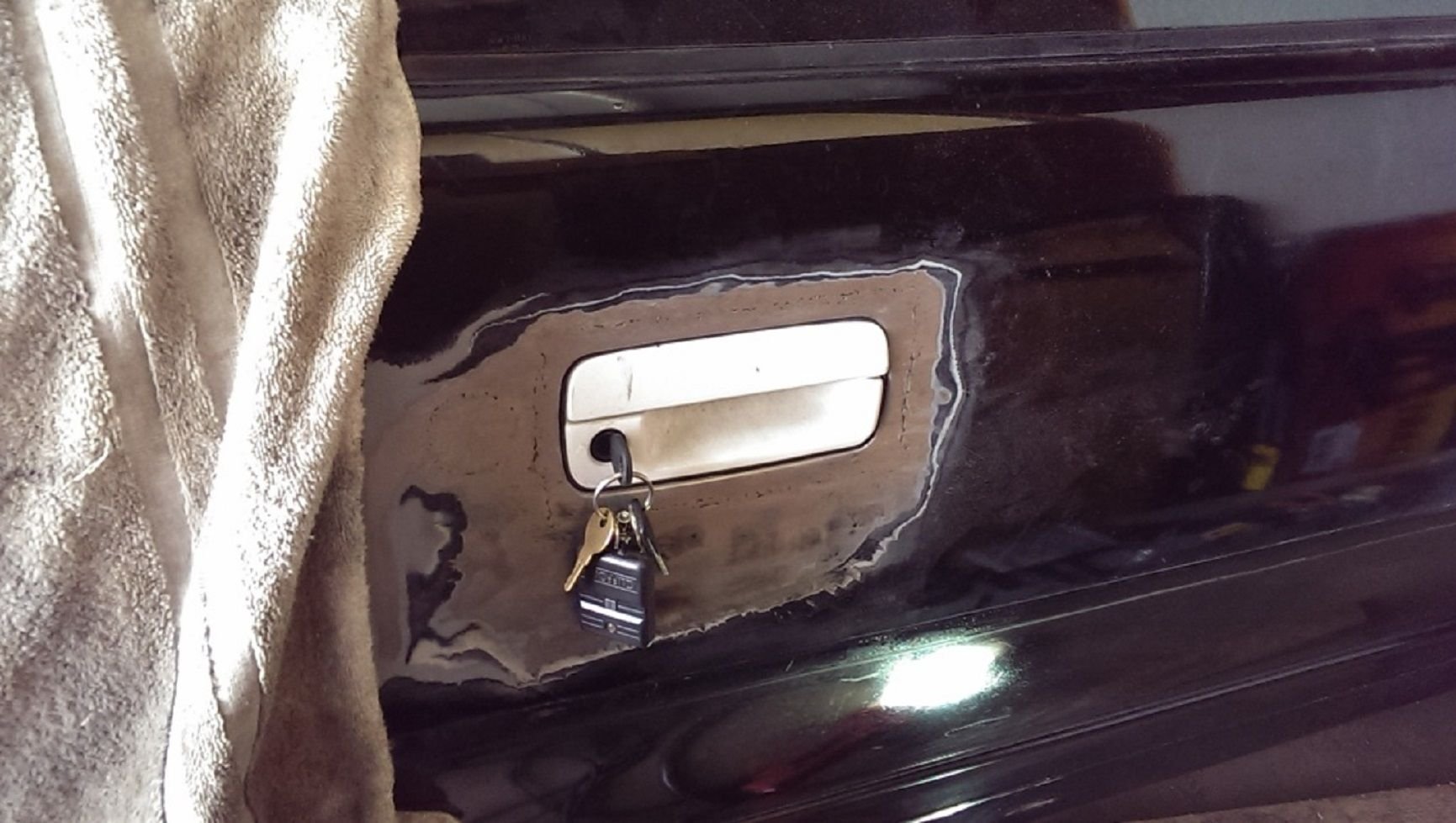

They look alot like caddy door handles!Was gonna use Grand Am units, but these are cleaner looking.Should have the Dr.side done tomorrow, minus body work.
All hooked up, even using my original key.Looks like $h!t, but ill clean it up later on.The lock functions opposite stock, but ima re-do the linkage too.

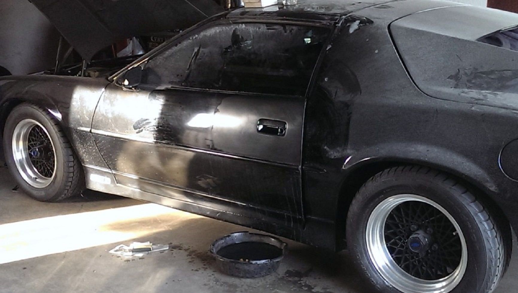

Updating, bodywork's done, plus blk handles from an eldo.

U should really do something about that oil leak by the door handle one of this days ur gonna trip on the tray u use to catch the oil lol jk jk It looks nice really clean

Thats next on the list.

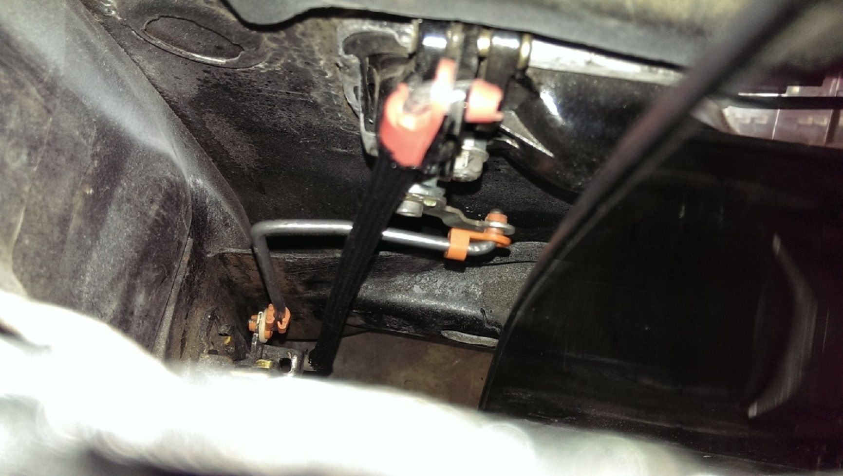

Thank you. Finished re-doing the lock linkage, works same as stock now. Window comes about 1/8 from touching the vertical rod. Braided sleeve in case the rods rub against each other.
