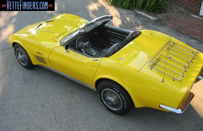

and here's a 72 vette. if you look closely you can see the chrome handle on the top part of the door

Yeah, those are C3 'Vettes. The Split Window was a 1963 and had a different style handle than what is being described.
I've been seriously considering the C3 style or idea of a door handle for my car for a long while, just haven't come up with how to get it all working in the small space I have to do it. It's a 1973 Datsun 240Z, that while it has a similar ledge at the top of the door, it is quite a bit narrower than the C3 'Vette and will require some very tight tolerances.
I may just end up installing the Grand Am door handles I already have, for similicity and getting almost the desired effect I want.
I had considered something similar to the C6 style, electric popper and all, I just prefer a mechanical door handle, just in case the power ever dies. Sometimes my car will sit for long periods, and like this morning the battery could be dead.

Believe me I'm painfully aware of the headlight situation, the first aero mod I do is going to be headlight covers, still deciding how I am going to attach them, and whether or not to make my own or buy some. I wouldn't be all that surprised if it actually takes off .01 or .02 from the drag coefficient.
And yeah, that yellow vette is along the right lines, though I would want it body colored, and as flush/integrated/seamless as possible, probably would do it in a different spot though. Probably a combo between what the OP did and what the vette has, the location and approximate shape of the OP's, but push in type like the vette, and when its pushed in, can just grab the door lip while the handle is recessed to open it.
