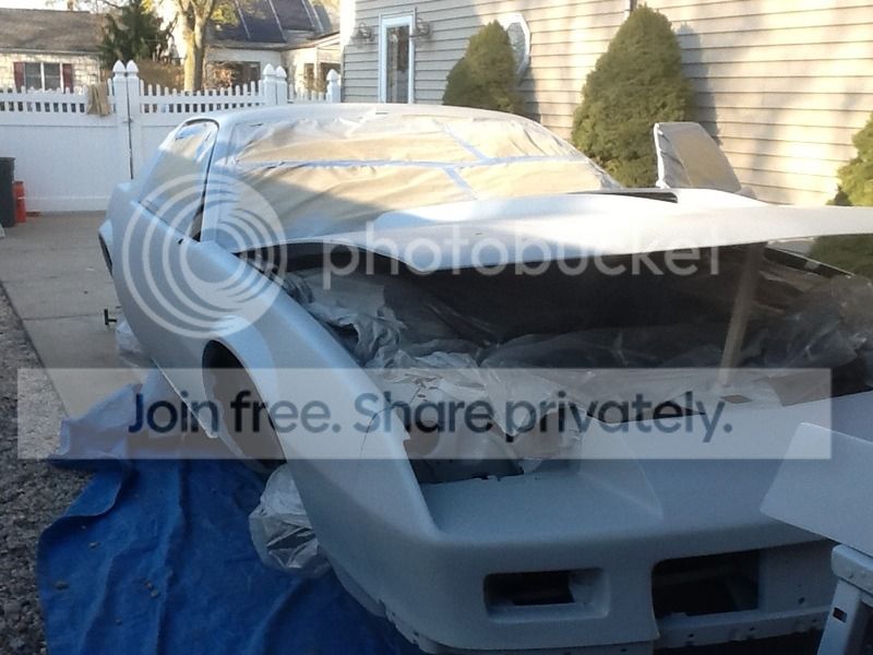

Shot the body and door jams with 2K primer high build 3 coats. Then black with 600 grit
Tomorrow with shoot the GFX parts

What color?

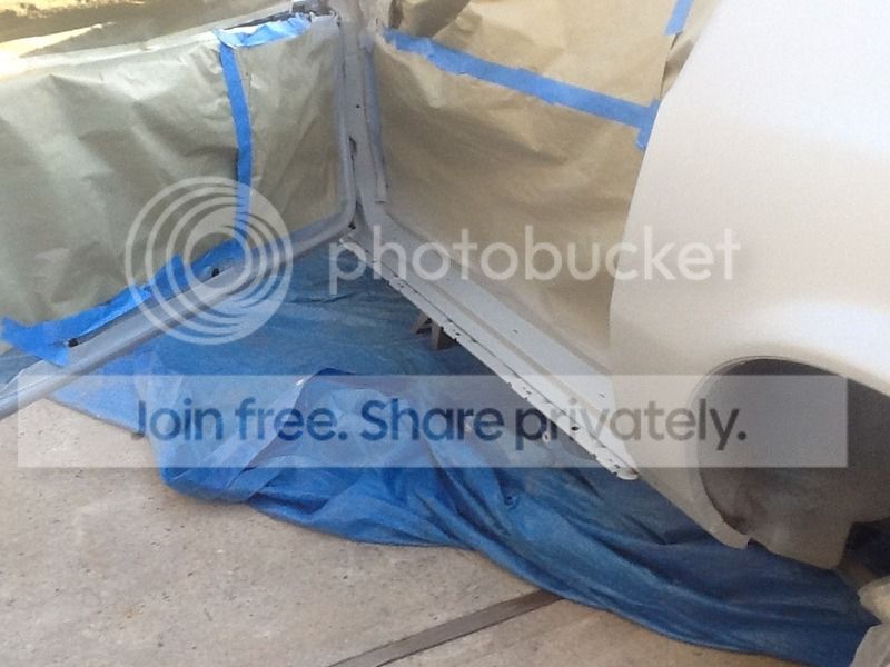

You might consider at least lossening the front and rear bumper mounting bolts so you can pull them apart from the fenders slightly. It will give you at least a little gap. If you fill the gap between the bumper and fender with paint you run the risk of the paint cracking, chipping or flaking at the edges where they met if they ever get moved or flexed.

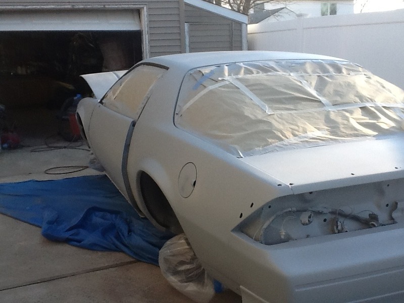

Color is a surprise. Iam painting it outside in a 10x20 canopy with curtains, I be had great success with this method

Any pics of your set up? I tried it that way once, but I had better results in the garage with a different set up... And I had a bit more room when it came to painting the sides.
Next time I do it will be in a different garage (I moved) or possibly in an actual paint booth at work!
