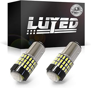

Yes they do and they have come along way in the past few years. I have fully changed every exterior socket bulbs with LED and it all works perfectly. I use these, no connection flip required.
Luyed 2 x 900 Lumens Super Bright. These bulbs fit the socket properly, some bottom out on the lip of the connector. They make these in different colors so I used the proper color for the lens, ie I used red in the brake lights. I used the Luyeds 2 wire bulbs for my side marker lights. I like this brand and have had zero issues with any of their bulbs. Luyed makes brighter bulbs but some did not fit right so they did not work right. Lastly I used this flasher. You will need this or have to wire resistors in the lights so this is a one and done. I love the brighter look I get from the LED's gives a more modern look.

Make sure the front parking light and the rear turn signal bulbs are installed properly. The side marker lights use the same ground as the turn signals, they alternate back and forth between the 2. I had that issue with the first bulb set, if one is not seated properly you do not get the proper ground through the system.
I had one of the cheaper bulbs go bad in the rear turn signal, The bottom connection pin. and the whole turn signal system would not work.
