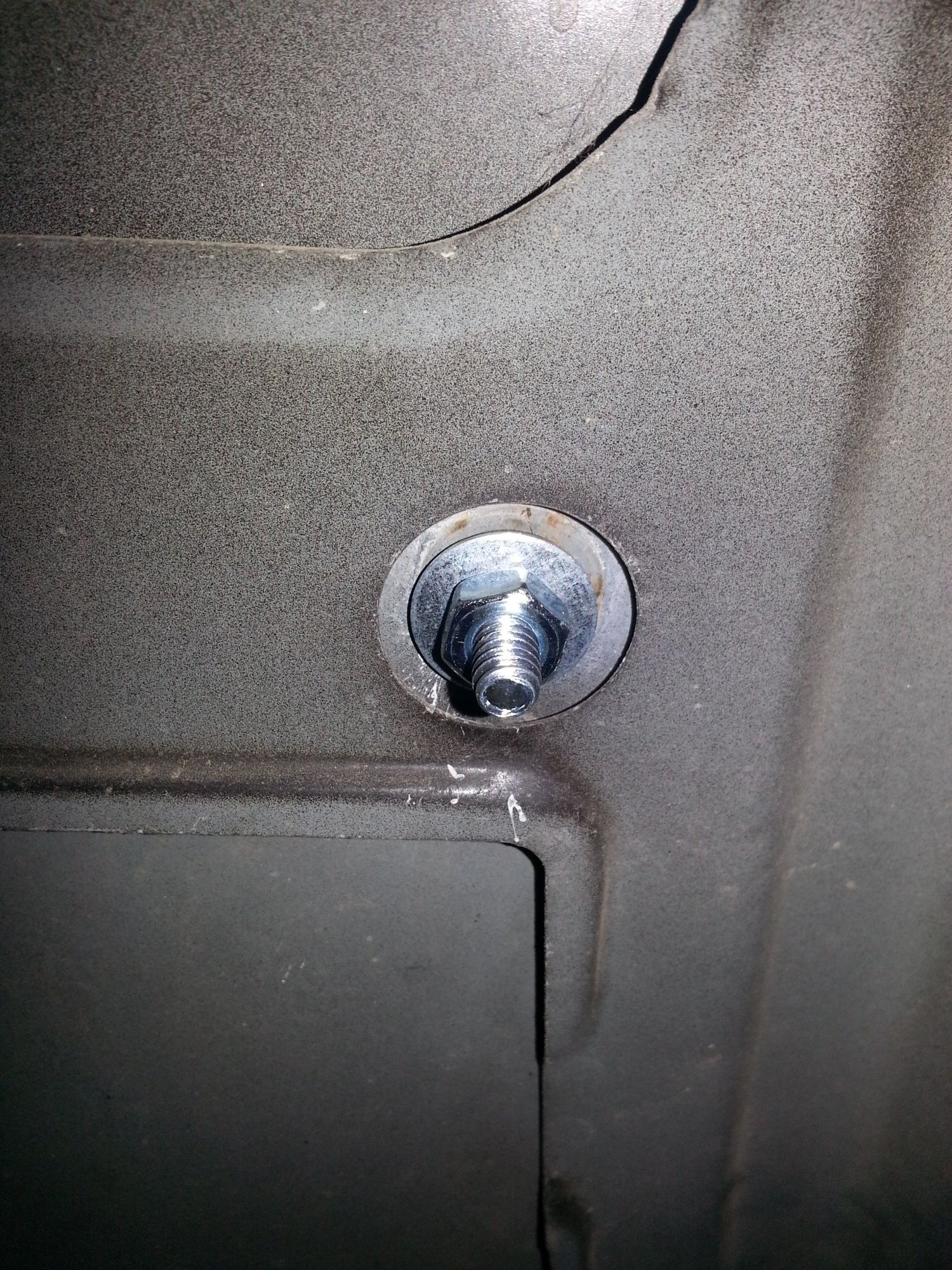

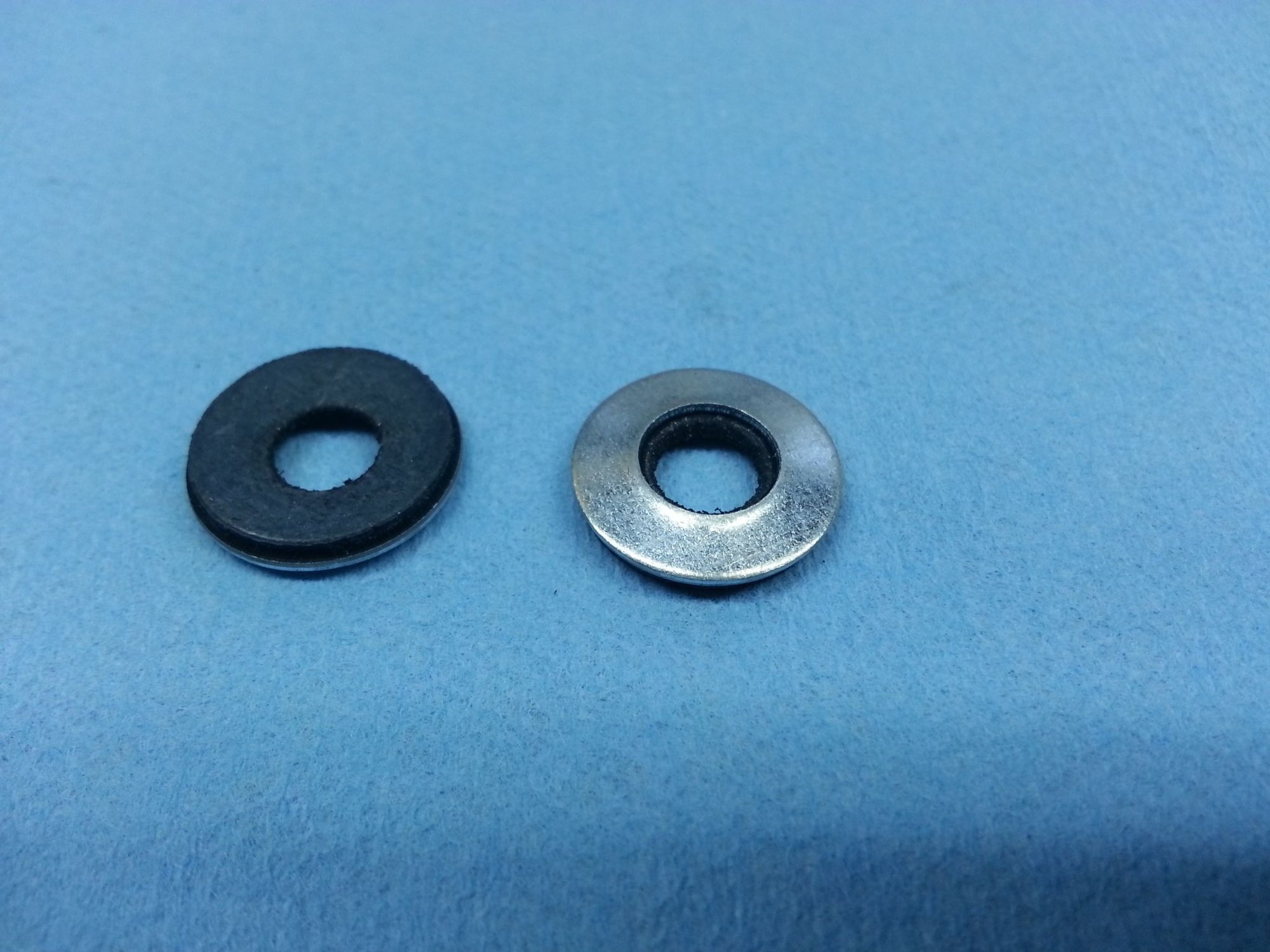

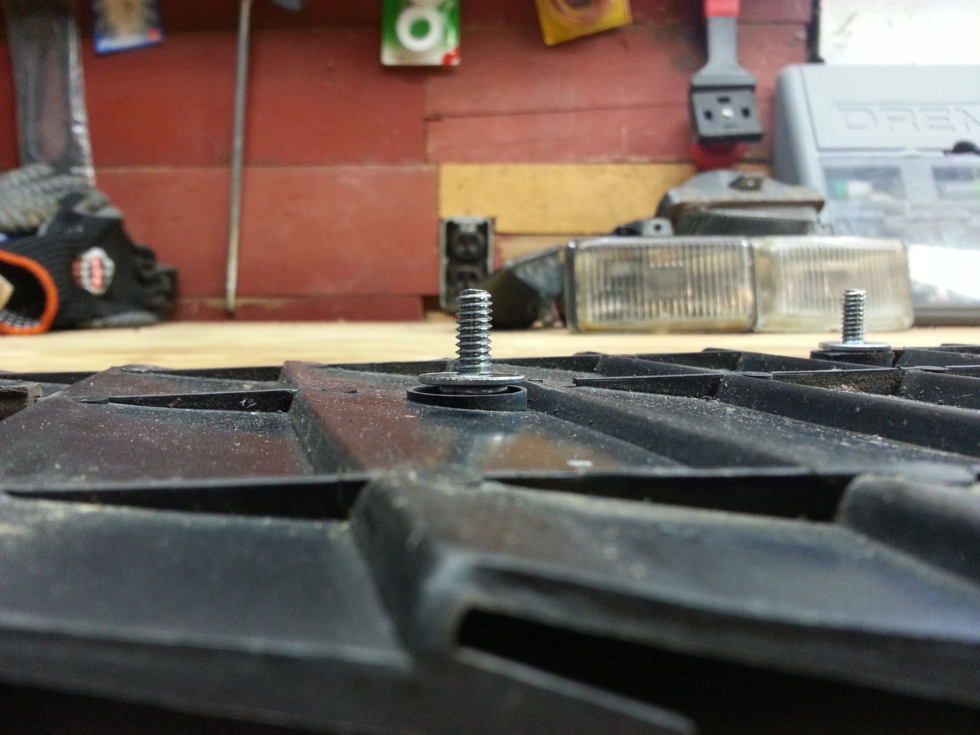

You take all the studs off and replace them with bolts, nuts, washers, and rubber pads. Mine are factory though and the whole project cost me like $10.

Originally Posted by cheves
What adhesive did you used?
Quick answer is Loctite epoxy, but for the full write up here is my thread listing what I did and products I used. Thread was posted in 2014 so you'll have to scroll down to post #7 for the pics.
https://www.thirdgen.org/forums/body...ud-repair.html
