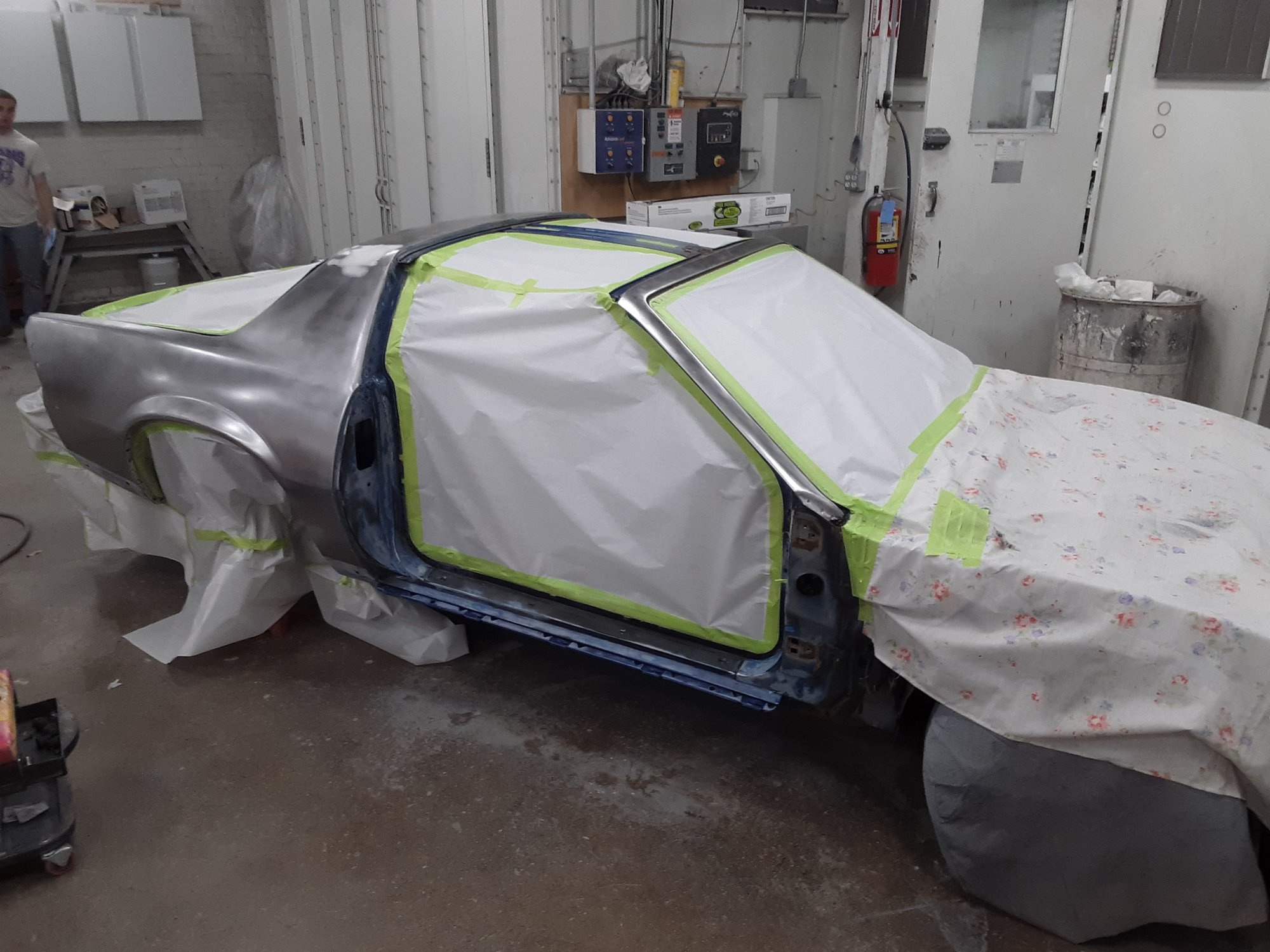

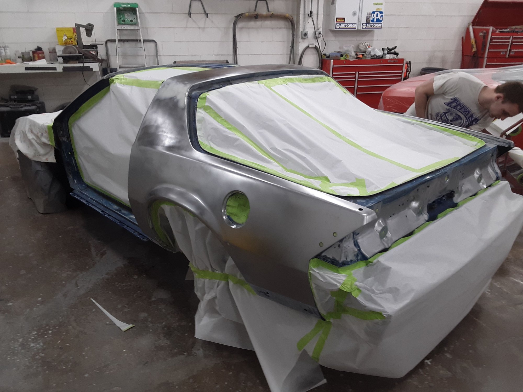

There is a factory seam in the place that you are describing. It's where the roof skin meets the top of the rear quarter panel, on the sail panel. It's not body damage, but some cars seams are more visible than others
If you look closely at these pictures of my car, you can see where I smoothed out that seam with a skim coat of body filler

Even the engineer from GM who worked on these cars that I met at Georgetown Tx car show last month looked closely at mine and said some 3rd gens show it more than others.
I call the cars that show more deformation the Monday morning hungover/Friday beer thirty cars and the ones not showing the rest of the work week cars. Lol

thanks everyone
