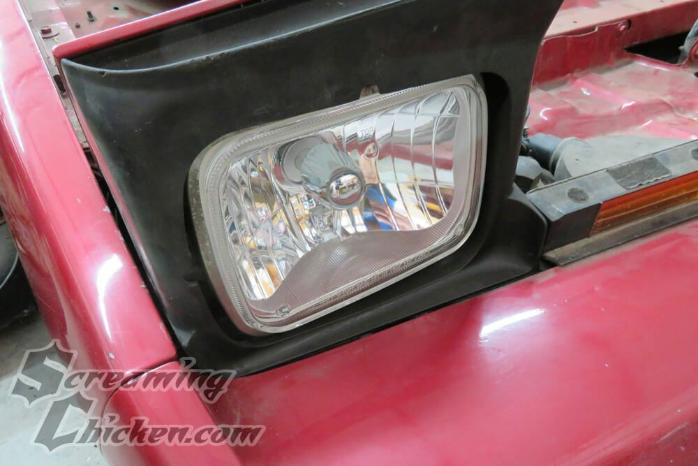

hh i saw it.
im not a fan of the clear more "modern" look though

Originally Posted by 1989karr
what do the united pacific lights look like? Do they look like the stock halogen glass?
