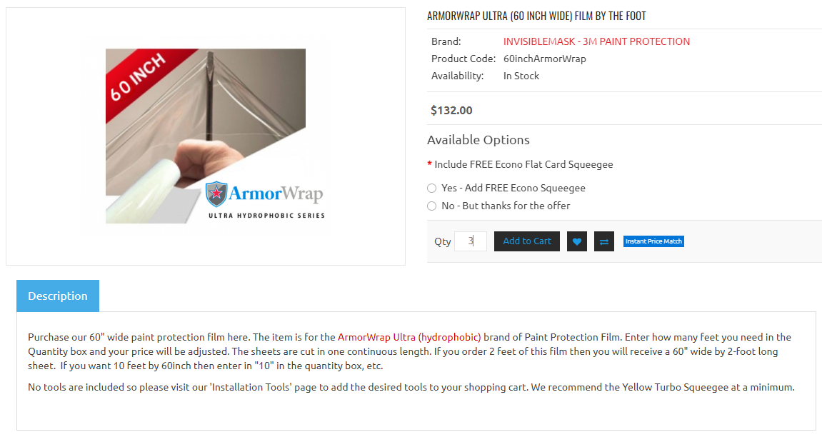

Email sent to www.invisiblemask.com
"Is the INVISIBLEMASK - 3M PAINT PROTECTION film good to use on Acrylic/Plexiglas? I have a set of Acrylic/Plexiglas automotive T-Tops that I want to wrap with a clear or a smoked translucent vinyl type of film. each T-Top is approx. 30"x30", can you make a recommendation?"
Thier reply,
The Armorwarp Ultra film should stick fine. The only drawback is how it will look when looking through it.
It is about 98% clear but that 2% may bother you."
Our cleanest/clearest film is the Armorwrap Ultra and we do sell it by the foot. You’d install it with soap/water and squeegee and then have to trim around the edge.
here’s the link
I've got emails out to both STEK and FlexiShield basically asking the same question.
