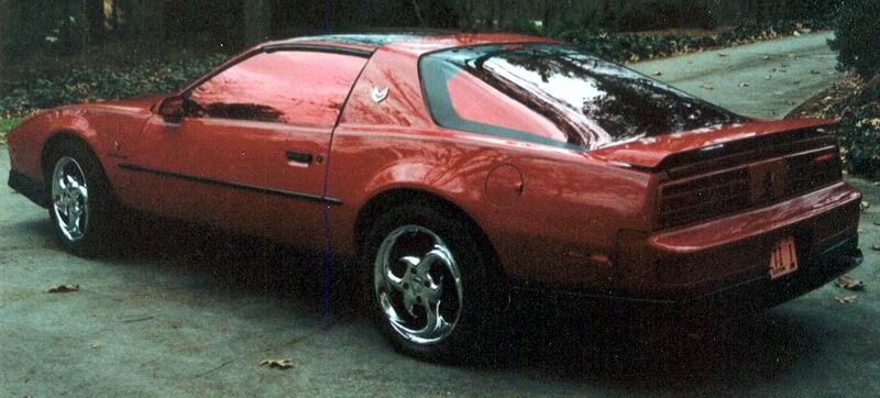

TheWraith:
Hey I got some shots of the spacers going on, but the files are too big. We have to size them down a bit and I will send you some shots of them as we installed them.
Here is a shot of the car from the rear so you can get an idea of the stance:

redraif, that doesn't look half bad. what is on your windows? is that transparent?

Originally posted by redraif
Here is a side shot so you can see the rims (5 lug to 4 lug):
yeah, good photoshop/psp job. first, your wheels are in the same "rotation" spot, but that might not be .
but the 91-92 camaro ground effects, and solid red window (without the weather stripping nonetheless is still.
Fine if you need more pics to prove the car is real.
www.cardomain.com/id/redraif
Everything is real. I would throw some shots your way, but they are on my work computer. The rim rotation was a fluke. Kind of cool though. If you look at the rear tires you can see the drum brakes that are red, so I must be one heck of a photoshopper.
As for the tint, It is red mirror. The shots were taken on the side of teh road on a very foggy day, so the windows are reflecting the glow.
Attached Thumbnails is it possible to put front wheel drive wheels on a rear wheel drive car-beach.jpg
