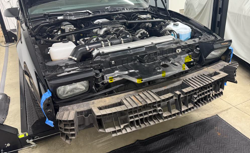

Alright so since I didn't find a video (that I thought was comprehensive) or thread on removing a Trans Am front fascia, I will add this and if it helps someone great. I also have the benefit of a 4 post.
Trans AM/GTA Fascia Removal.
  • Remove LH, RH and Center section of the lower air dam
  • Remove the LH ground effect on the lower fender- 3- 10mm nuts, 2- 7mm screws in wheel well and 3- 7mm under front
  • Remove the RH ground effect on the lower fender 3- 10mm nuts, 2- 7mm screws in wheel well and 3- 7mm under front
  • Remove center air dam that funnels air to radiator- 8- 10mm head screws and 4- 7mm head screws
  • Remove the lower 2- 10mm head screws from the lower part of the fascia to fender on both sides
  • Remove 10mm sheet metal nuts on the upper 2- screws both sides fascia to fender- these are locators screws for the fascia to fender
  • Remove 7 push pins underneath
  • On upper side- remove turn signals assemblies- 2 screws each
  • Remove 5- 10mm head screws on bracket that attaches to the upper structure. This piece is a full cross car at the top of the fascia and actually has the alignment pins that go to the fender. See yellow highlghts on pic that shows bolt locations
  • Remove fascia- pull straight forward to clear the alignment pins to the fender. It helps to have two extra hands to ensure you don't scratch up the fender in the process. It will be more important when it goes back on.
  • Once the fascia is off, taking the upper bracket out is tricky as the 4 studs protrude through the fascia and its tight to get it out. Once again, its good to have another set of hands to help.
Caution- When installing, the two tabs that connect to the foglamp brackets (underneath) must be flexed out of the way for the fascia to go straight on. Otherwise it holds it from getting to its position.

Old Jul 8, 2025 | 08:47 AM
72buickgs's Avatar
Joined: Oct 2021
Posts: 745
Likes: 117
From: Windsor, On
Car: 1984 Trans AM
Transmission: 700-4r
Re: How do i remove my front and rear bumper covers?(88GTA)
I printed the instructions of Hessm70 for future reference. TKX
