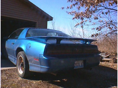

Originally posted by Karps TA
Jim,
I think he's talking about using a stock 4th gen wing, not the ASCD replica correct? If that's the case you've got alot of work ahead of you, it's not a direct bolt on. Your goind to need to do some fabricating, and some bondoing. Search the site for 4th gen wing and look for Scauffiel he's the only one I've seen thats done it.
I used one too. Didn't write any measurements down though. I did use some stainless screws though, to hold it in the original slots on the front.
