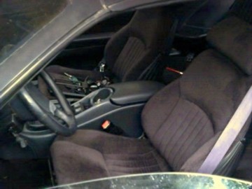

Swap was a piece of cake. I used the 1st generation style(4th gen) center console. Went it very nice w/no mods--other then the window a mirror switches(which I haven't mounted permanently yet ). There is a lonmg piece that-when mounted-slides under the radio pod, I didn't have to cut it off--actually helped to center it.
Attached Thumbnails 4th Gen Consoles????-4th-gen-console-1

Another angle.
Attached Thumbnails 4th Gen Consoles????-4th-gen-console-2
