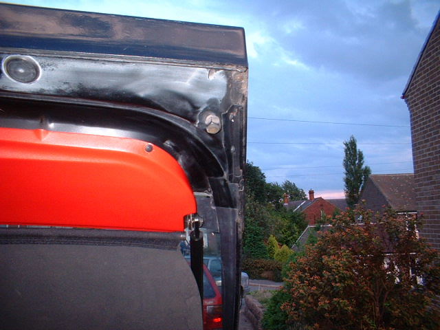

I have 2 Camaros and they both are the same under the hatch. Check out the photo. Mine has those "pads" as well.
A sure fire way to check where water is coming in is; (time consuming but well worth it)
1) Remove all interior panels in the hatch area and carpet and underlay. Take as much out as possible to make spotting it easier. Even remove the plastic panel from under the hatch.
2) Go and get some talcum powder and generously chuck it over every metal surface you can see, where water could be coming in. Don't forget the metal panel under the hatch. If you choose the smelly stuff, you will have a nice smelling car as well!!
3) Close hatch and go and get a hosepipe (or wait till it rains). We don't have to wait long in the UK for this! Completely saturate the car. Leather off the excess (don't want the water dripping in and spoiling the evidence when you open the hatch).
4) Now for the fun bit! Open the hatch and look for tell tale signs of channels in the talc where the water has run.
Hope all this helps.
Andy.

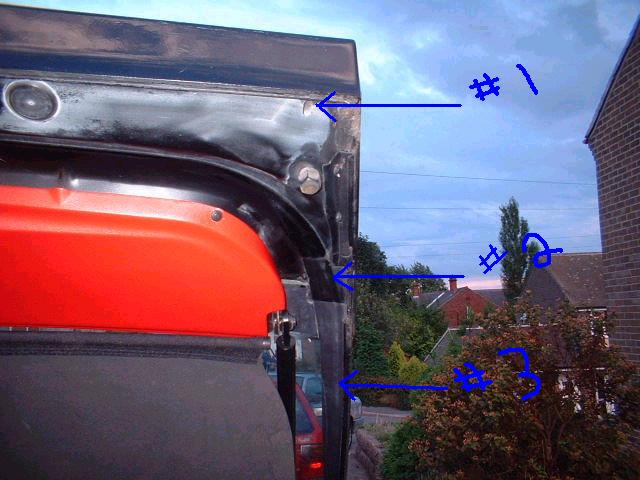

Thanks a lot! now i can explain a couple of things to you guys...on the picture i should have attached with this, hope it works i never tried it before...anyway, #1 should show little grooves near the back of the hatch, now on my hatch they are actually holes(if there not supposed to be holes can anyone point me to a product in which to fill these?) #2 shows the little plastic pieces i was talking about, so now i know they're supposed to be there, however #3 shows what looks like weatherstrip, that runs along with #2 the square plastics, i do not have #3...no stripping at all on the underside of my hatch except for the square things....i thank all of you for all your help, thanks for the picture Andy

in the pic that you sent, it looks like there is a peice that fits over the bottom rubber. The plastic peice that you are pointing out. I don't even have that peice on my hatch. That's probably what my problem is. I'm glad that you sent that pic, I didn't know that there was a peice for the upper part. I've got a wear in where the bottom rubber and the top part of the hatch meet. I hope that's all I need. :fingers crossed:

Is the wear you are talking about right where the plastic piece is? that's exactly how mine is on both sides right where the plastic squares are...and i don't have anything else on the underside just those, i'm leaning towards that being the problem...still doesn't solve the headlights though! any thoughts on the two small holes near the back, right over where the tail lights would be? thanks guys

In QATransAm's photo above, the leak is extremely likely at arrow #2. The fix is to disassemble the hatch and reseal it. You have to unbolt the metal tail portion from the glass, install new sealer, and reassemble. I can't overemphasize the benefit of a factory shop manual for this. You'll have to support the glass before removing the struts and tail panel. Flex occurs at the joint and it eventually creates a leak. I think you'll have to use a little of that black urethane windshield "glue" around those plastic pieces at the ends. Nothing else I know of sticks to them.
Good luck. I'm redoing mine (for the second time) tomorrow.

Upon disassembly I discovered that the sealer I had previously used was leaking most of the way across the glass. It had either shrunk and cracked or pulled away allowing major leakage. I cleaned everything up and did a couple of "dry runs" at reassembly.
I came up with an idea. Instead of using some kind of sealer (silicone, urethane, butyl, etc.), I am going to use foam tape. It is available in several different sizes and materials. Use either "high density" closed cell PVC or nitrile rubber foam. The latter is designated as "automotive and marine". Do not use low density, or open cell foam. It will not keep water out. I installed some 1/4 thick x 3/8" wide (3/8 x 3/8 might be even better, if it's available) completely across the edge. I also installed a short strip on each side to where the plastic transition piece comes in. I will use sealer only in the two little troughs (one on each side) from the transition piece to the front edge.
In my dry runs, the tape seems to fit very nicely and compress just right providing a good seal. Because there is some adjustment involved, and the panel is rather unwieldy, I am going to wait until I can get a couple of helpers for installation. I want one guy on each end and one below installing the backing plate and nuts. This way, it can be squarely lowered into the exact correct position with minimal adjustment.
Once you have applied the sealer, you need to place it perfectly and not be resetting and moving it around. You will cause gaps and holes and therefore leaks. As shown in the tech article, mark the panel location with tape. I have found that even with that, the holes on the side for the metal glass trim may be off slightly. So before even snugging any of the nuts, the small screws should be installed to get the alignment correct. Then tighten everything up.
Because sealer will squeeze out around the transition pieces, I will put a piece of wide masking tape on the weather stripping (on the body). After all of the bolts have been tightened, close the hatch and let the weatherstripping form the overflow sealer. You will get a perfect seal, and the tape will keep the sealer from sticking to the weatherstripping. After it all sets up, open the hatch, remove the tape, do a little trimming, and reinstall the trim. Done.
If this foam tape idea works, it will beat the hell out of the messy sealer approach.
