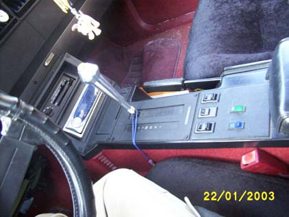

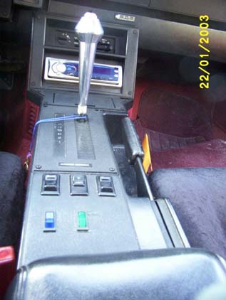

i made mine out of 2inch round aluminum and 3/4inch brass for the button. this was a week long project...
i taperd one end of the 2inch wide alum to 45* and matched to its point, then i put a 3* taper from the other side to the first taper.
then i drilled a hole through the entire shift knob1/3 wide(i think). then at the large end i cut a 3/4 hole about an inch and a half deep.
i got a boreing tool and i put a lip above the inside of the 3/4 inch hole no mor ethen 30thousanths deep.
i drilled a hole 1/16th through the brass and machined a piece of steel to fit freely through the hole. i cut the steel in half and put a spring in the hole. i put th etwo pieces of steel through each end and put the brass inset into the top of the aluminum.
The Spring inside the middle of the brass inlet would push the two small steel inlets outward and when put in the aluminum it will make the brass piece stay, and the lip on the alum will hold it in place.
Then i fitted a rubber inset to go to the bottom of the newly made **** **** and then placed it on my camaros shift button thingy.. below is a diagram, as soon as i get time ill scan the pics and post them here..

THAT, is bad azz! What did that cost ya? I want one!

ok finally i have pics of my shifter. i know my crappy paint pics didnt do justice but these pics dont do much justice eaither. the entire **** except for the button i made out of aluminum so i polished it and damn it was shiny. so the sun reflected off it and well u get the picture. theres three in all but ill only post the two best.
Attached Thumbnails Home made shift knobs and pictures!-shifterknob-amp-button-head

and the side.
Attached Thumbnails Home made shift knobs and pictures!-side-view-shifter-knob1.jpg

Kinda looks like a microphone....

yea it sorta does. later today ill take some pics without the damn glare ill see if u can see the brass button. the entire **** took 3 days to complete. (but i was in machine shop at the time only working an hour a day)
