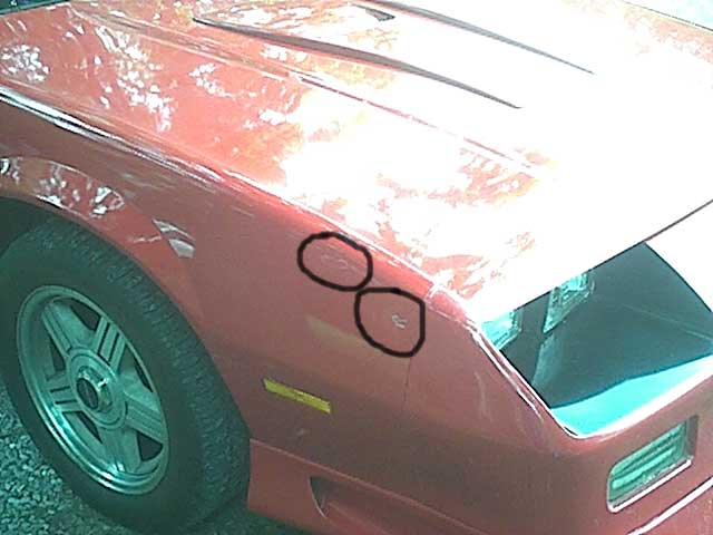

a while back i got hit and the person ran..now my insurance had been calceled at the time...the estimate was $388.42
is that a rip off or does it sound about right?

i definally wouldnt pay 388 to have it fixed, id put in touch up paint for now then fix it when u go to have it painted

I would get it fixed for one reason.
1. It looks like a nice car, and this happens way to often where a person gets in the mindset "Well it has that chip in the front" then they skip washes and waxes, hit the curb more. And before you know it, a nice car has gone to ****.

$388 for those two dents is pretty a good deal. I wrote an estimate the other day for 3 dents about that size on the decklid and 2 quarter sized dents on a roof for a grand total of $660.00.
If you plan to paint the whole car soon I would buy a fender and put it on yourself. If you buy an aftermarket fender the shop may have to adjust it for you since some aftermarket body parts don't fit all that great. Your best bet is buy used.

The reason its so expensive, is because to properly fix this, you must:
A) pull the dents out to original contour, or pull out and fill in to original contour,
B) prep and seal the surface
C) match the paint and blend
D) clearcoating requires application to the next feature line (i.e. ground effects, moulding, etc...) or panel break, so that means the whole fender needs clear coated.
You can save up and have it fixed properly, or you can do what I did, and learn to do it yourself.

I don't know, $388 sounds really pricey to me?
I hit a big box truck and smashed my front bumper's headlight pocket really bad. It needed quite a bit of repair, plastic welder was used, and the paint split is so many different area's from the street, and it actually bent the passenger fender just a touch and cracked the paint.
They repaired everything perfectly, not a single wave, ripple or FLAW in it for $100
By the looks of it, it looks like you could pop that dent yourself also..might save you a few bucks.
