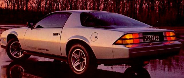

Ok, the red tail light thing has been done before, you paint the inside of your tail light lense red, and the amber goes away. I just did this, and I wanted to share a few pointers for those of you who keep asking about it or want to try it the first time....
First off, I want to note that this is on a 92 RS Camaro, so I don't know if it applies the same for firebirds, and also, I used VHT Metal Tint, which was recommended to me by Redraif.
Ok, separating the housing from the lense is a bit tricky. There are basically 4 places where you can easily break your lense. I'm gonna point these out, so you know what to look for...
There's two black plastic push pins that go in the top of the housing. Your first impulse is gonna be to pull them out, but mine were brittle and they broke off. I ended up cracking part of my taillight there. Here's the trick. Look at the backside of the tail light. You can see that the pins are visible from the backside. You can push up on them, and they'll pop out and you won't break a thing. Do this instead of trying to pry them out.
The second two places you're going to risk breakage, is there are two places on the lense where the housing is meant to "snap" in place at the bottom. These fit loosely, however, the outside lense is extremely stiff plastic and it's fragile. You're just going to have to be careful with these, I've warned you. I don't know any tricks for making it easier.
Take a small screw driver and pry out as much of the silicone sealant as you can, and then gently start prying away the lense where you see the sealant. The lense should separate from the housing, with gentle force. Be careful not to concentrate too hard on any one area, or you will break the lense, and again, watch those tabs on the bottom.
After you've separated the housing from the lense, get some adhesive cleaner by 3M, and go around the outside of the lense, and clean off as much of the sealant as you can. I used a small screw driver to dig it out of the housing. You will see a little channel going all around the inside of the housing, where the sealant was meant to go. Clean this out as best as you can. Now you're ready to paint.
Make sure you wipe down the inside of the lense with some kind of adhesive cleaner, or paint prep for plastic, and a tack rage or you willl get fisheyes or worse.
When painting, make sure and mask off the rest of the lense, so there's no overspray. I found it helpful to keep the outside of the lense unmasked partially, so I could compare the stock red, to the part I was painting. If you want, you can paint the whole inside of the lense (except the white parts), to match. I just did the orange part. The inner white piece on the corners will come out easily if you're gentle. You can remove this and paint the whole inside of the lense.
Use slow even strokes and be careful not to cake it on or you will get runs.
Once all this is done, you can simply shoot some more sealant into the housing, I'm using clear silicone, and then snap the two pieces together. Put the pins back in, and you're done!
I probably won't have any pics to show, I didn't take in progress pictures, and I don't have my car handy to install the tails, but here's basically what you get..... Please excuse the wing, it's not my car.

OMG!!!! IT IS A **** ROCKETED THIRD GEN!!! this is a sad sad day.

say it isnt so

I bet they have to measure height clearance from the spoiler....
My comment wasn't directed at Mathius I saw where he said it wasn't his car. I was just stating what everyone else thought too. Nice write up on the Tail lights.

so what color does the old amber light shine? Isnt it supposed to stay amber?

i saw this on the site but it applies "wings are for airplanes" other than that it looks good with the red tailights :lala: :lala: :lala: :lala: :lala: :lala: :lala:

this post has absolutely nothing to do with a wing. The guy explicitly said to pay no attention to the wing AS IT WASN'T HIS CAR.
Read before posting ladies and gentlemen. This is what drives members from this site - childish behaviour that has nothing to do with the technical nature of an honest post.

Originally posted by TomP
Actually, aren't the taillights with amber blinkers called "european" taillights?
Tomp,
AFIAK, from searching the net and mostly this board, where you'll find more information than anywhere else, there were several different kinds of tail light designs, but they all had amber in them. There's the Berlinetta's, which have a silver cast to the area where the license place lights are, there's the european style, and then there's the american regular version. Also, you have the grid style, and I assume although I've never seen it, the european grid style.
The European lights have the amber part located in a different spot on the lense. If you do a search, there are some posted somewhere. The best pic I could found is this one.....
https://www.thirdgen.org/techbb2/att...postid=1099794
