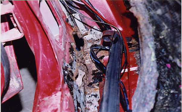

inside:

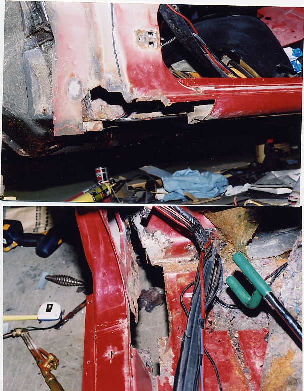

next job was to cut out all the crap and then sand blast and treat the surrounding metal (with rust neutralizer).

Then I broke out the torches and molded a patch that replaced the inner rocker, floorpan and came out through the body into the wheelwell.

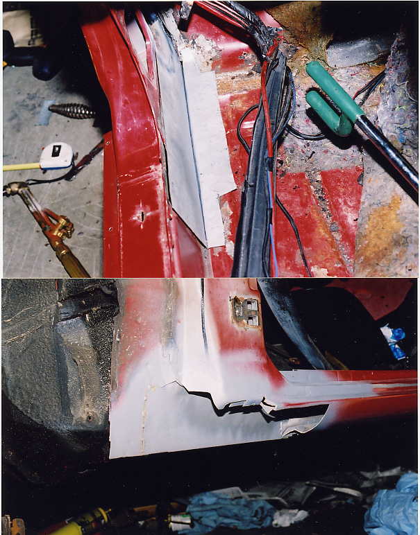

Then I made a patch for the outside (thicker gauge steel - 18) and rebuilt the flange for the fender to attach to. I then sealed it and paited her up!
Hope this helps! Feel free to PM me if you have any questions.
