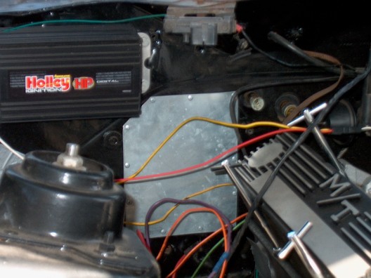

here is what i did. i took a piece of sheetmetal and riveted into place. i still need to do the hole for the blower motor but the ac compressor area is filled. i am ditching the heater and ac. i am planning on buying one of those under dash heating units so i can defrost the windows but thats it.
A little off topic, but how do you like the holley digital module? I have one sitting on the floor behind me, and hopefully will get around to installing it tomorrow. Has it been pretty reliable? I picked up the digital module and lazershot pro coil brand new for $100 shipped
Looks like a very high quality piece, weighs about 5 lbs too

i did a little reading about it and it is very comparible to others so i figured why not. i got it new for 100 from jegs when they where being clearanced out. i havent tried it yet as the car isnt running. i am getting closer to finishing the motor though.
