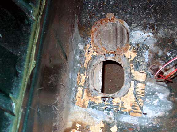

There is 5 total on a thirdgen f-body. One smack in the middle of the truck, 1 sitting under each rear passengers feet, one splaced neer the driver's feet, and one at the passenger's.
Picture of a drain hole.
Attached Thumbnails Do i need the floor drain/plug things?-inside1.jpg
