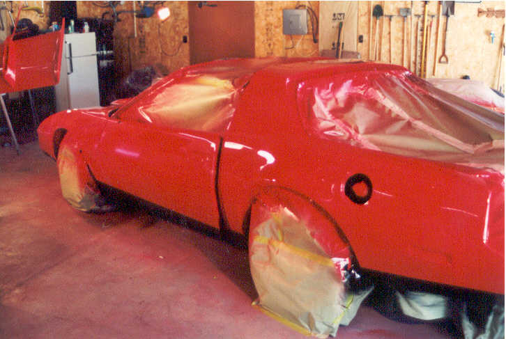

Go with the original red like I did
If you are wanting to seal the metal,
I used all PPG product, that started
with a wash primer/metal etch, then a
high build primer, much sanding with a
block and stick, then sealed with an
urethane primer, then urethane base coat,
wet sand base coat, then the final base coat,
and then 3 coats of acrylic urethane clear,
then after its dried for a day, wet sand
with 1500-2000 paper, and BUFF, BUFF, BUFF:rockon:
