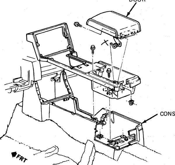

I just got a new spring in the mail for the latch on my console lid. I have the spring the plactic latch and then the two halves of the lid...I've been sitting here for hours and can't figure out how it goes abck together...Am I missing something here? Can anyone tell me how it works..it seems so simple...maybe i'm dumb..

Hello LD1985,
In case someone hasn't already done it, welcome to the board. While I can't exactly give you any specific instructions with out seeing it. I can give you this picture of it and hope it helps you out some.

Okay LD1985,
It is a rather straightforward procedure. Take the inside half of the lid, put the plastic latch piece in with the hook in the hole facing forward. Put the spring behind the latch piece, take the outside half of the lid and have it tilted slightly at the front so the covering will go behind the front piece of the inside half. slowly push them together and put the two screws in to hold it together and that's it. Sorry I don't have a picture of it. Should take all of three minutes to do it.
