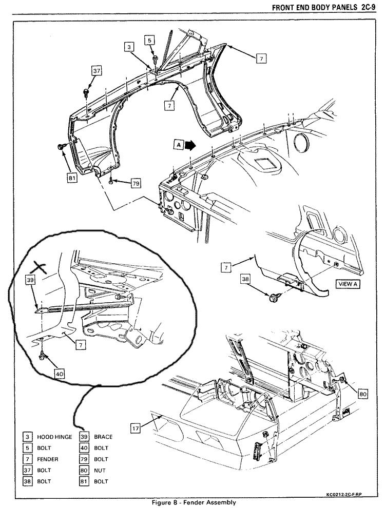

As mentioned earlier, it is a brace for the right fender.

It is a fender support brace. It is standard on all Z28's. 1LE cars, and many 91/92 TPI Firebirds.
It also goes with another brace going from the fender well in the engine compartment to the fender rail near the motor.
It is there to stiffen up the body.
