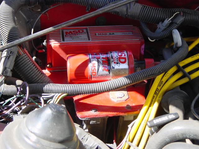

Not if you get creative and find something to plug the hole
WTF?? Would someone let me know why the pic doesn't work?? Is it because I left spaces in the file name??

The hosting site probably doesn't support hot linking images.
Here it is...

Thanx for hosting that Scott, but I uploaded it to the same place cra-z-canuk has that pic up top hosted, and its a site specifically for hotlinking. Do the tags look ok?, because all I did was click the IMG button and paste the link in there.

LaxStreetRacer- I just got done doing almost the exact same thing to my car. Weird.

LOL, thats about 5 years old actually, im gonna try and clean those harnesses up this winter then make a fiberglass lower piece and probably re-make the top plate as well, its really starting to show its age. post a pic of yours if you got one.

To see the picture, I copied your text and pasted it into a new browser. It showed just fine. The parentheses and all. I just removed the [img] tags. Don't know the answer.
