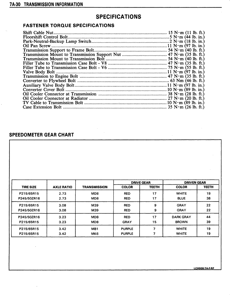

Originally posted by Apeiron
No other changes are necessary to make the 145 mph head work other than swapping the head itself.
So this chart wouldn't apply to making the speedo work accurately?
Not at all. He already has the correct speedometer gears.
