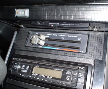

That's all I did was change the panel, the actual controls are still for an a/c car. all iever use anyway is either the defroster (very far right) or teh max a/c setting to turn on the fan (second form left). It makes it look like a factory non a/c car. (under hood and the controls).....

do the controls come apart so that u can switch the plastic faces?
the camaro ones do..
its just a clear plastic cover with a printed sheetmetal/plastic piece under it.
atleast all the ones ive used have been that way. i had a 82 and a 91, so if they both have it, i assume all the years in between did.

MrDude ... you are the man, hah, thanks for the info about them panels, im just gonna switch them up on mine. and it will be ALOT easier than riping my whole dash apart. i have another question.... does anyone know what the 2 hard plastic vac lines go to that come out of the AC harness?
