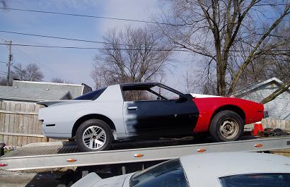

I finally decided that my black/primer gray/white/red/green/maroon/blue paint scheme has to go. I have enlisted the professional skills of jay92,85,79 from the boards to get the thing done in time for Thirdgen Fest '05.
Here is a pic taken on Saturday afternoon when the flatbed dumped it off at jay's. I had already removed the engine/trans and everything on the firewall:

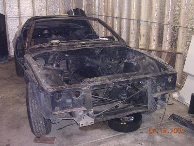

By the end of Saturday night, this is what the car looked like- no doors, fenders, headlights, bumpers, engine wiring harness, etc:

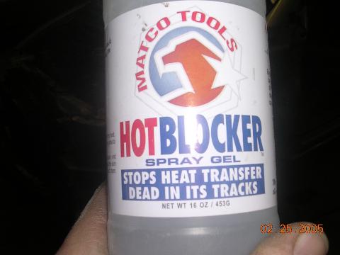

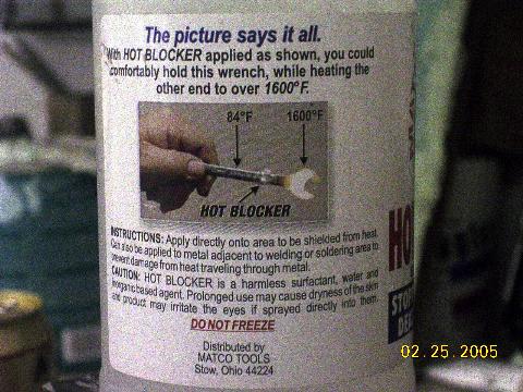

The spray stuff sounds interesting. I've seen the putty for retaining heat and I usually just use wet towels and/or an air gun but, I'm always open to new/better ways.

yeah i don't know if its thinner than 20g or just junk metal. Prob little of both.lol Yeah if i remmber to take my cam to work i'll take a pic. The stuff u spray it on after u are done just wipe it off. The stuff is the coolest thing i have seen . I think i have wasted more trying to melt sh*t with it.lol

here is that stuff its called hot blocker

this pic kinda hard to see but its a guy holding a wrench that really hot. I tried this it worked

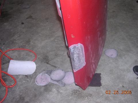

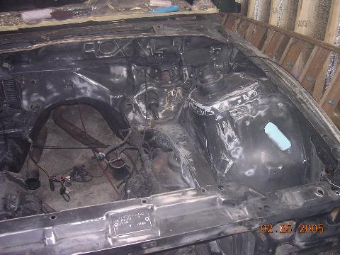

ok here is what was done tonight. Pretty much got the engine compartment ready for paint. Shaved the ant and filled holes

Hey bud.. thanks for the info.. appreciate it.

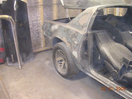

More progress. Jay emailed me pics tonight so I updated my Car Domain page. Since the TGO "rule of 3" is in effect, I'll just post one more pic on this thread and give you the link to my page so you can see the rest.
Click here for the latest body/paint pics. Jay ended up sanding off all the primer I put on the RH 1/4 panel since it was lacquer primer and is prone to shrinking and cracking:
