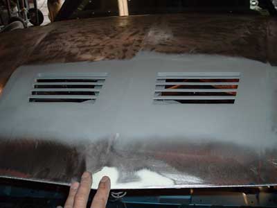

ok I did this and i regret most of it. I would suggest using fiberglass in the front of the mold on scocp. I got a mold on hardwood 4" cowl and the mother ***** broke threw the body filler and the front now you can see threw the paint a big line that goes across...SOB... i used body filler for all the seems. Honestly everyone thinks its a full fiberglass cowl hood. Untill they see this big crack on the front. Pisses me off. just be carefull . almost every mold on cowl i saw started to crack threw somehow. You have no clue how much work i did on this hood to get it to blend in perfect. With all the labor i could have worked and bought a bolt on fiberglass cowl EASY.
Attached Thumbnails Adding a hood scoop or cowl to a stock hood?-c-documents-settings-sean

so body filler cracks? not trying to insult you but are you sure it just wasn't a user error? I've known that stuff to crack from working in the shop at school, but I'm not sure exactly what its limitations are for doing a cowl.

it could have been i dunno just let me know when your done .. i think it was the moisture cause everytime it cracked i saw alittle water i dunno just let me know when your done how it goes

and also token.. the lips on the end of the cowl are like a 1/4 thick. So i used a lot more filler then i thought i was going to, good luck.

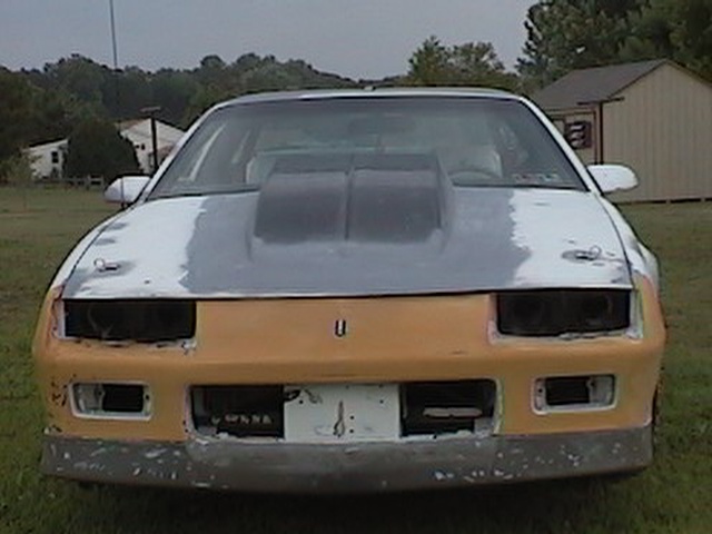

I think after your done buying the cowl,glue,fibeglass/filler.And your time trying to make it so no one can tell. Your going to be pretty close to the price of just buying the hood. Metal and fiberglass Act differnt around heat and cold. The bondo will crack, fiberglass will crack.I did the vents on my TA hood. I knew it would crack. But want to see what it would look like and did not think it would crack 2 days after i got done wet sanding and buffing the car. So to waste your money and time to do something that might not work...hmmmmm i would just buy the hood... but just my 2 cents
Attached Thumbnails Adding a hood scoop or cowl to a stock hood?-c-documents-settings-owner
