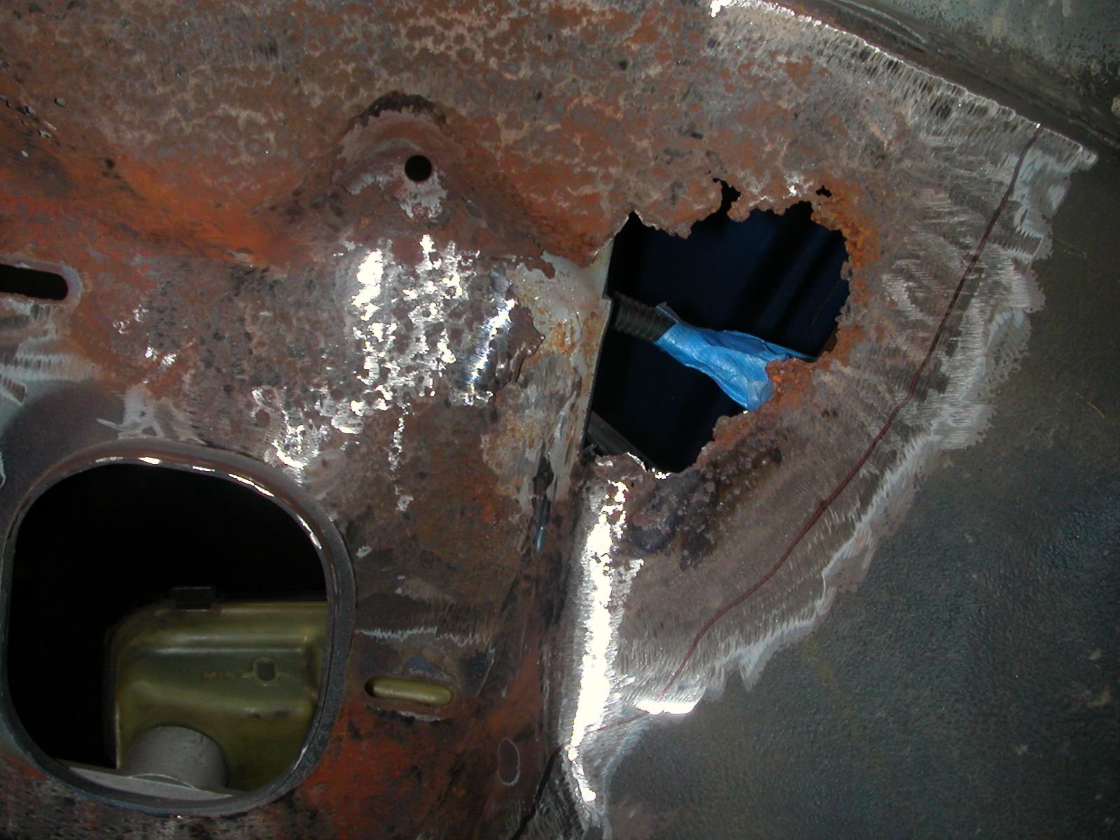

Repairing strut tower rust

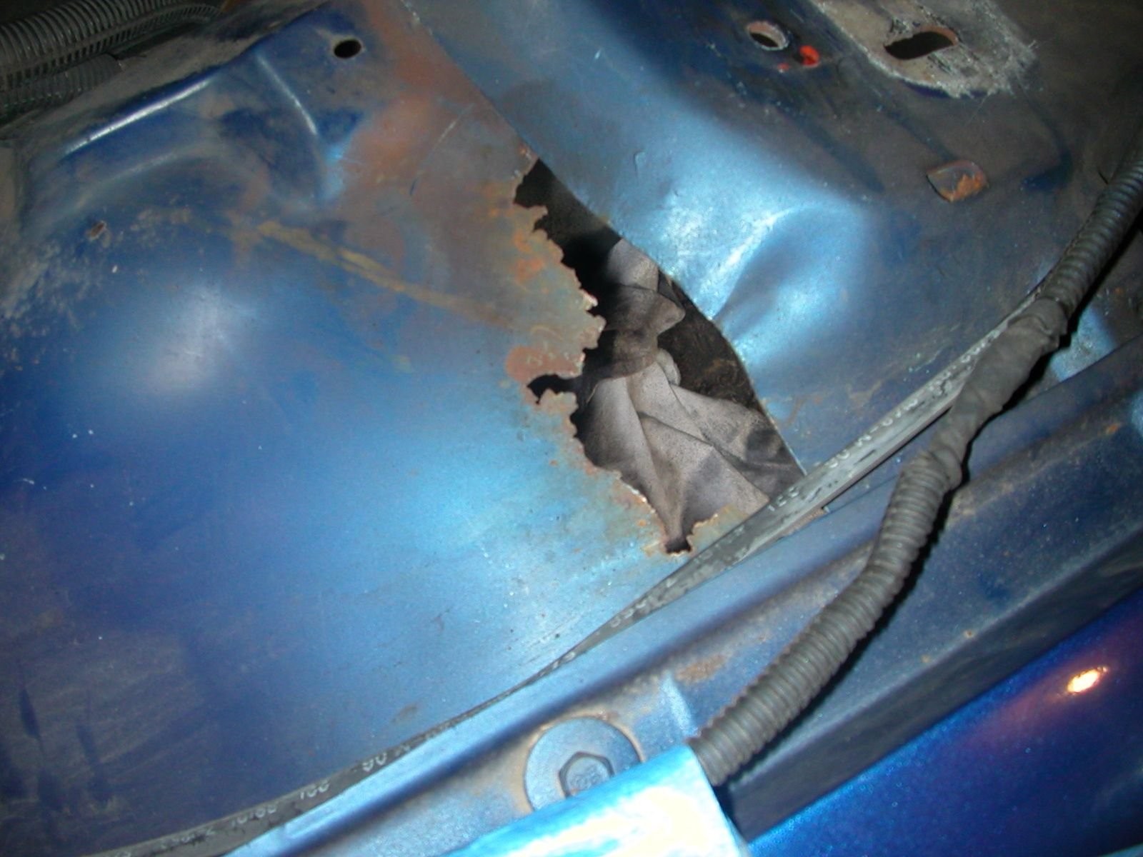

So I have the same problem that many third gen owners have with the driver side strut tower rusting out from the wheel well in. I searched the forums and I couldn't find any post with some pics of the repair process, so I thought I would document mine. There's nothing like taking a cutting wheel and welder to your car!
So here was the problem after I took out the strut and upper strut mount and got rid of most of the bad rust so I could see what I was dealing with.

another from the wheel well, you can see the line where i want to cut

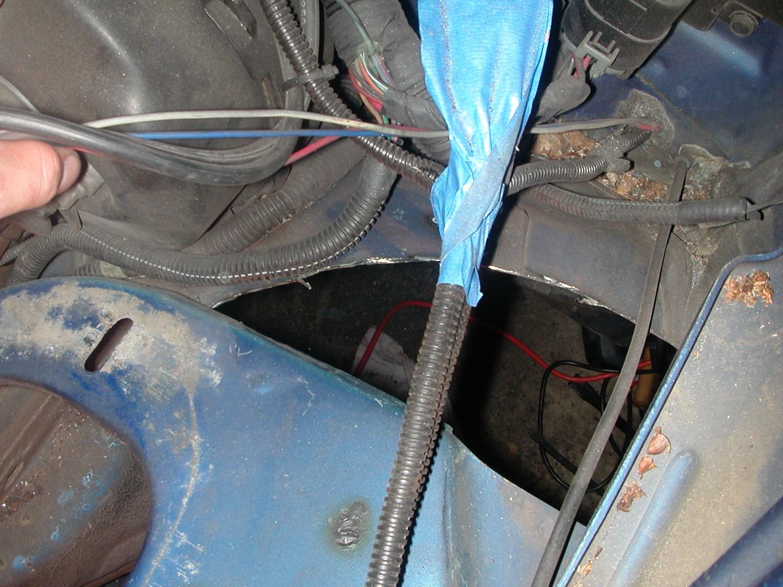

this is the one from inside the engine bay

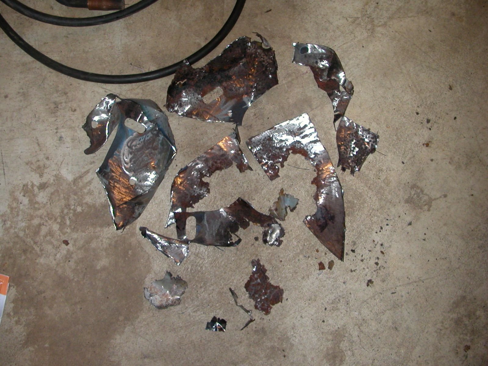

here is all thats left

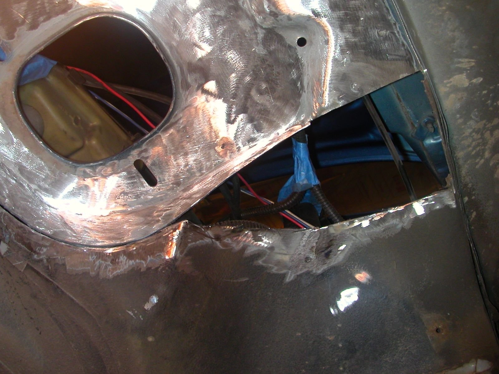

here it is, all it needed from this point is i small piece on the back part, and two large pieces on each side.

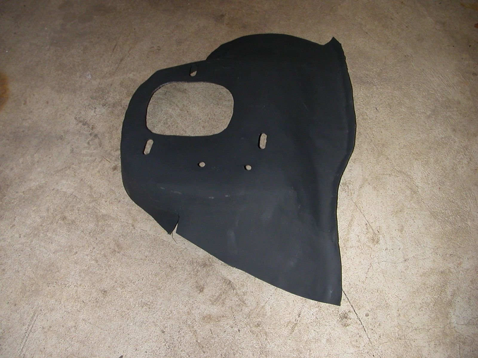

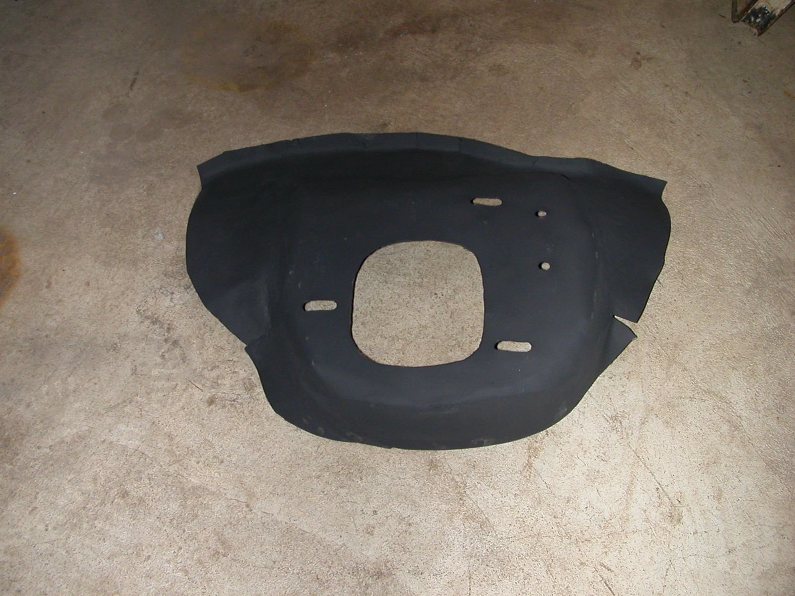

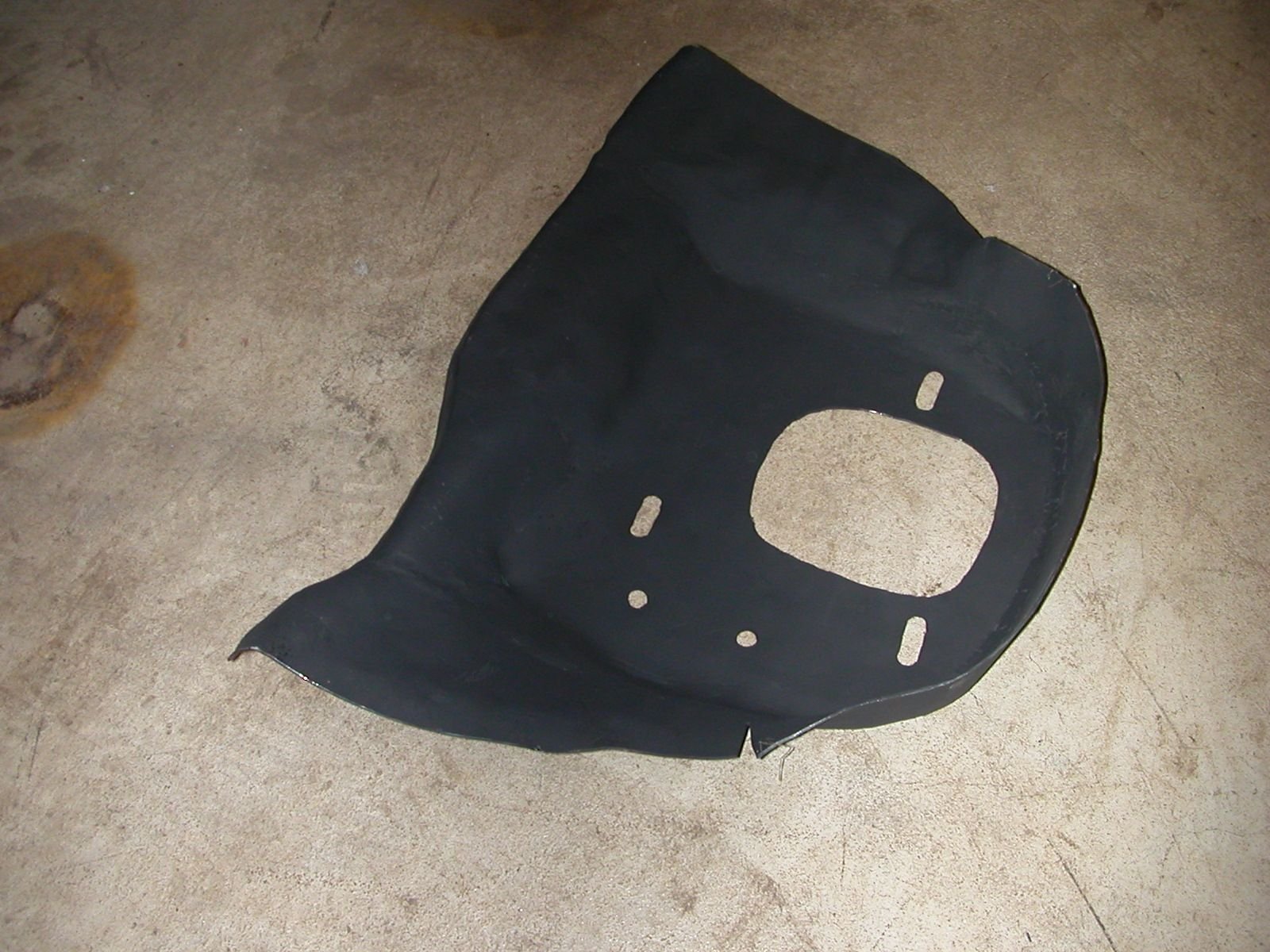

jump ahead a whole lot of welding, hammering and bending, this is the piece out of the car, primed and ready for por 15.

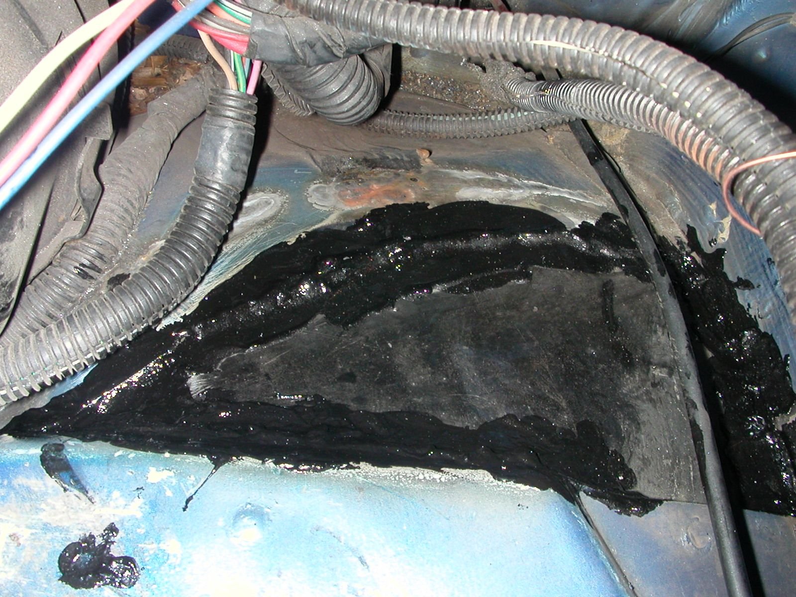

so to end today off, i painted the underside of the strut tower and the top side of the "new" wheel well with por-15. Tommorow I'll be welding that piece in, painting everything, and that should be it.

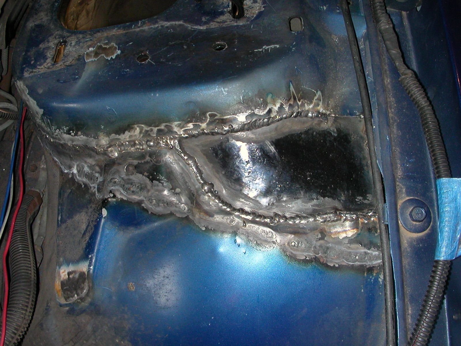

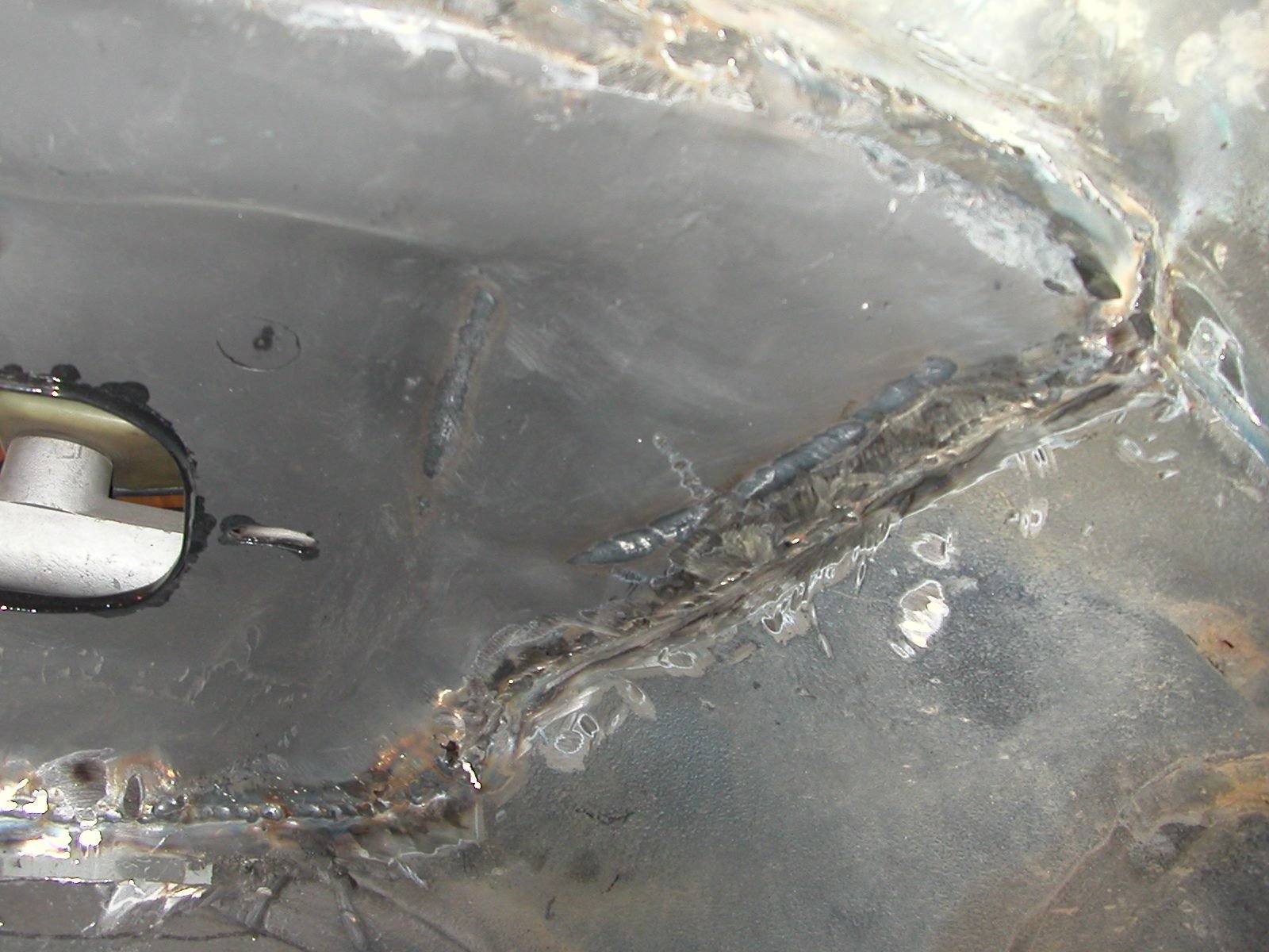

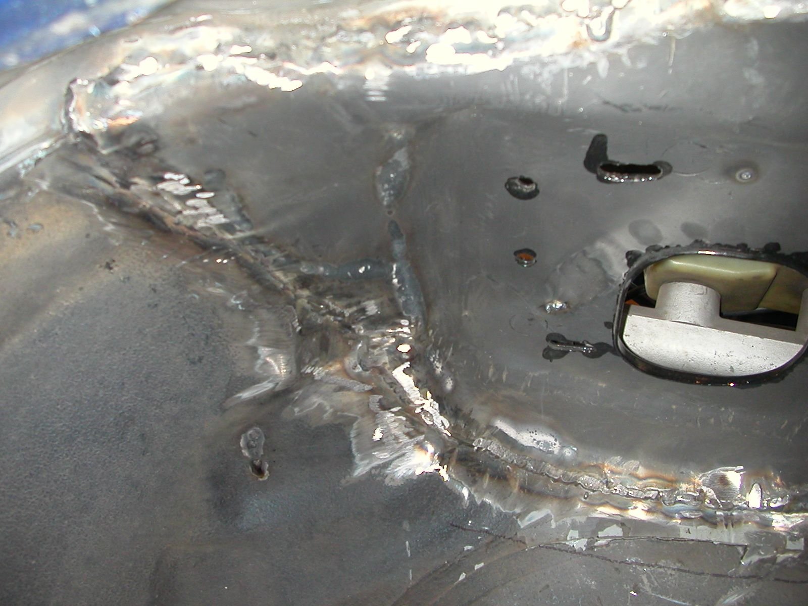

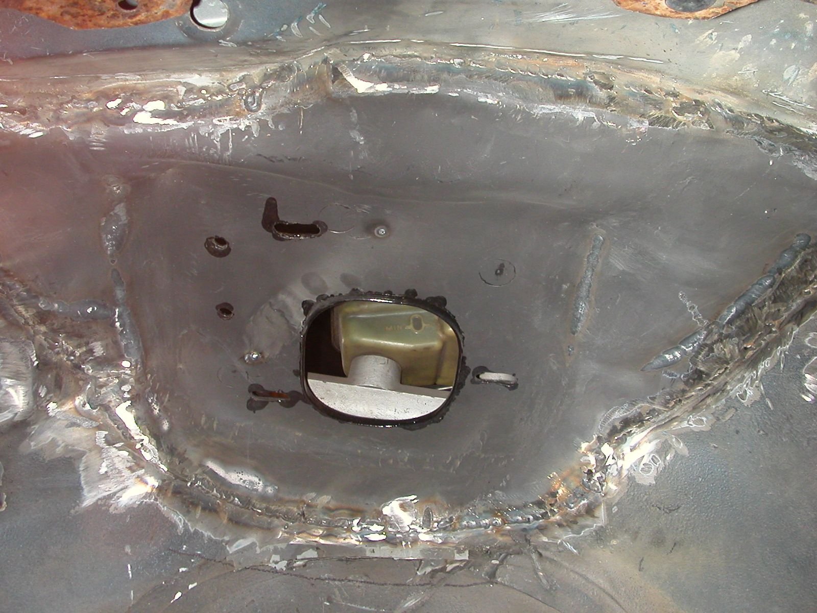

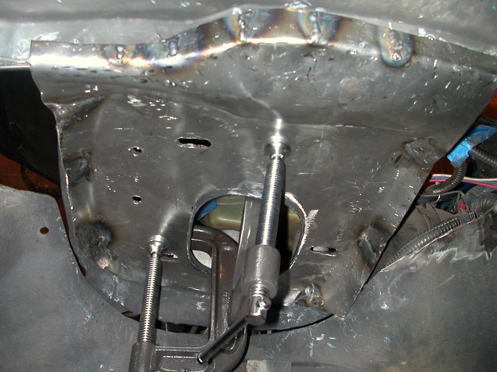

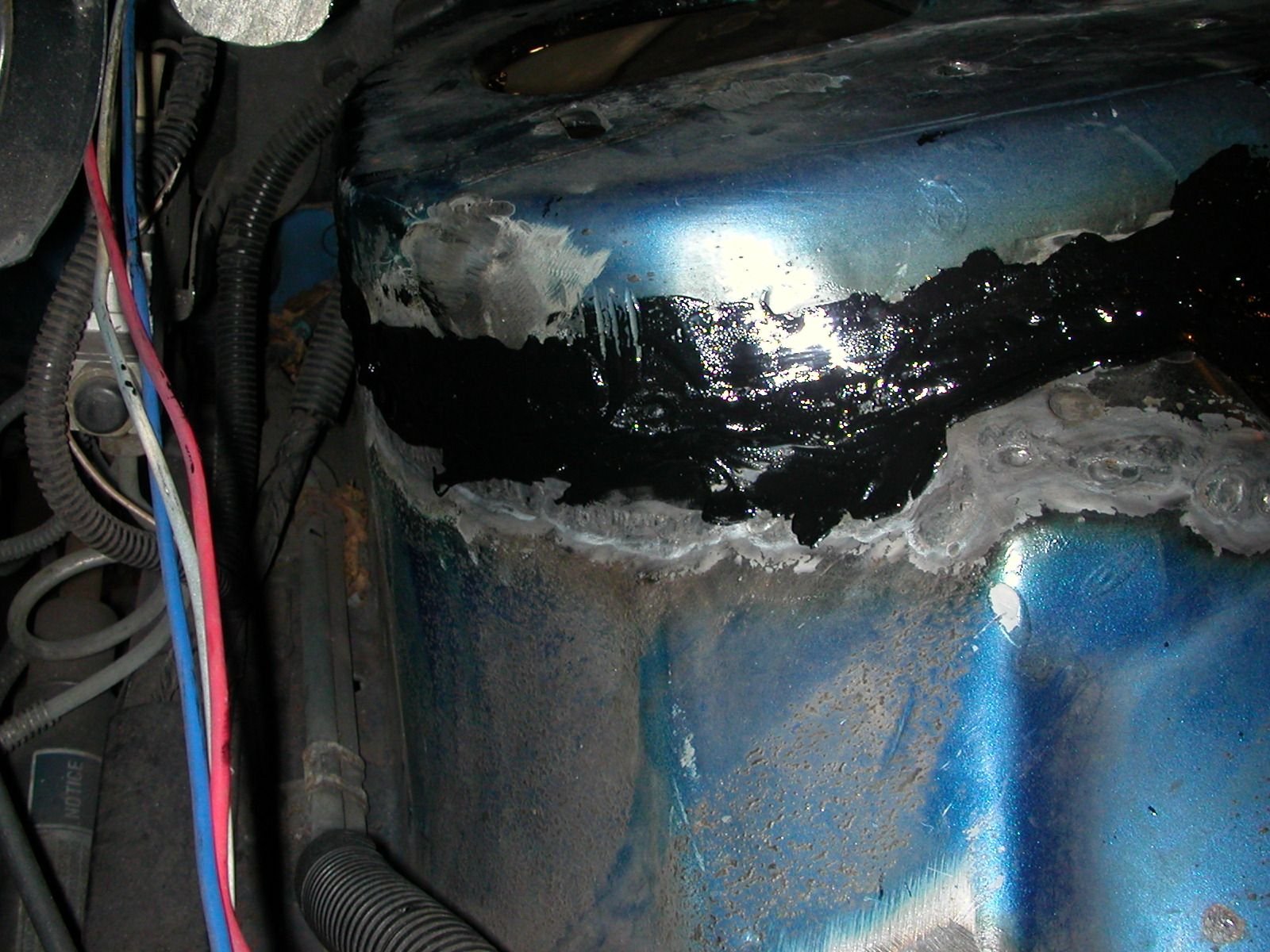

So ten years later I'm going to finally finish up this thread....
I clamped the patch piece to the strut tower and started welding...
Old Apr 10, 2015 | 02:51 PM
mgilorma's Avatar
Joined: Jun 2003
Posts: 319
From: Lansdale Pa
Car: 90 RS
Engine: 305 TBI - LT1 Cam
Axle/Gears: Stock Crap
Re: Repairing strut tower rust

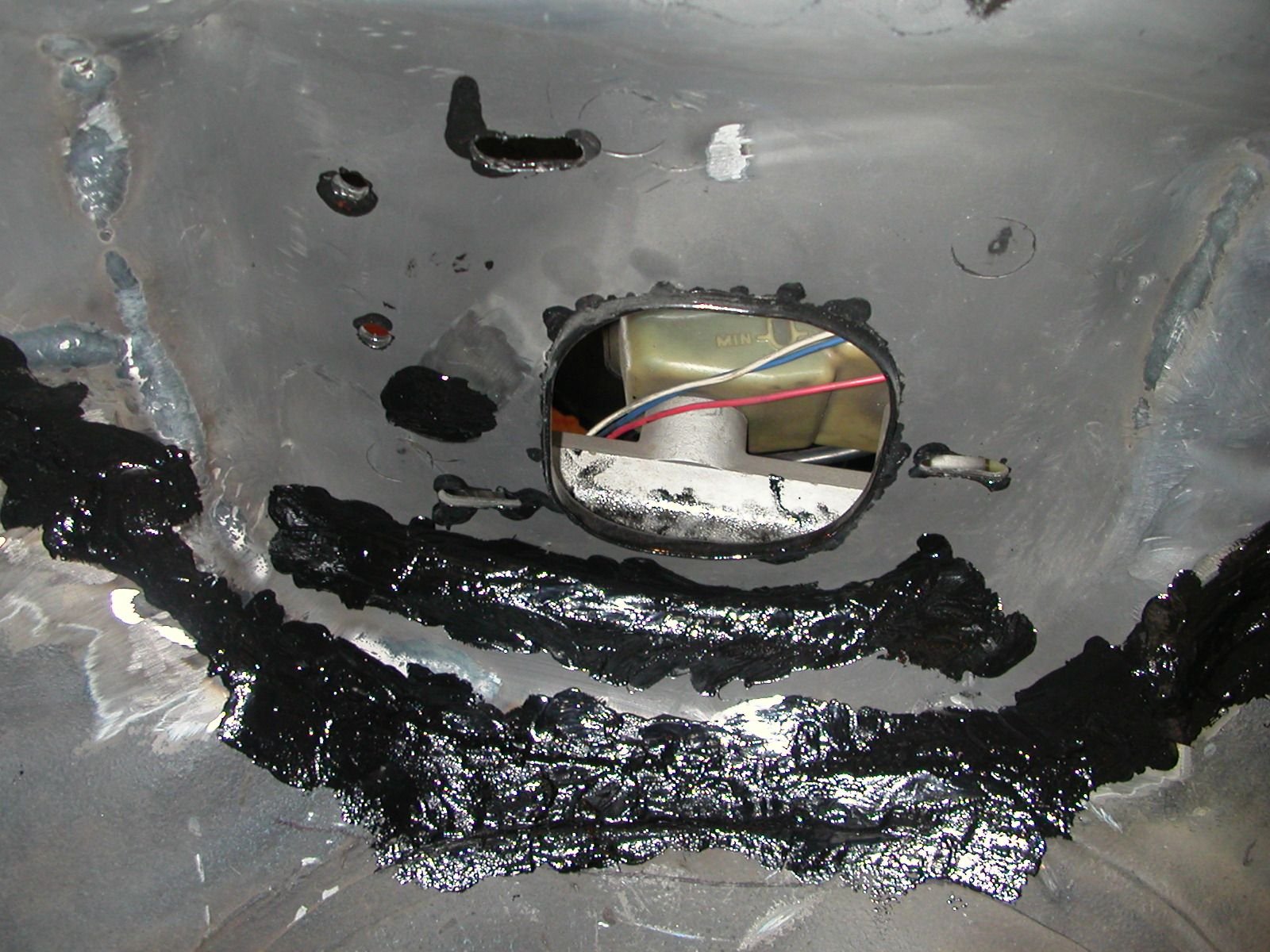

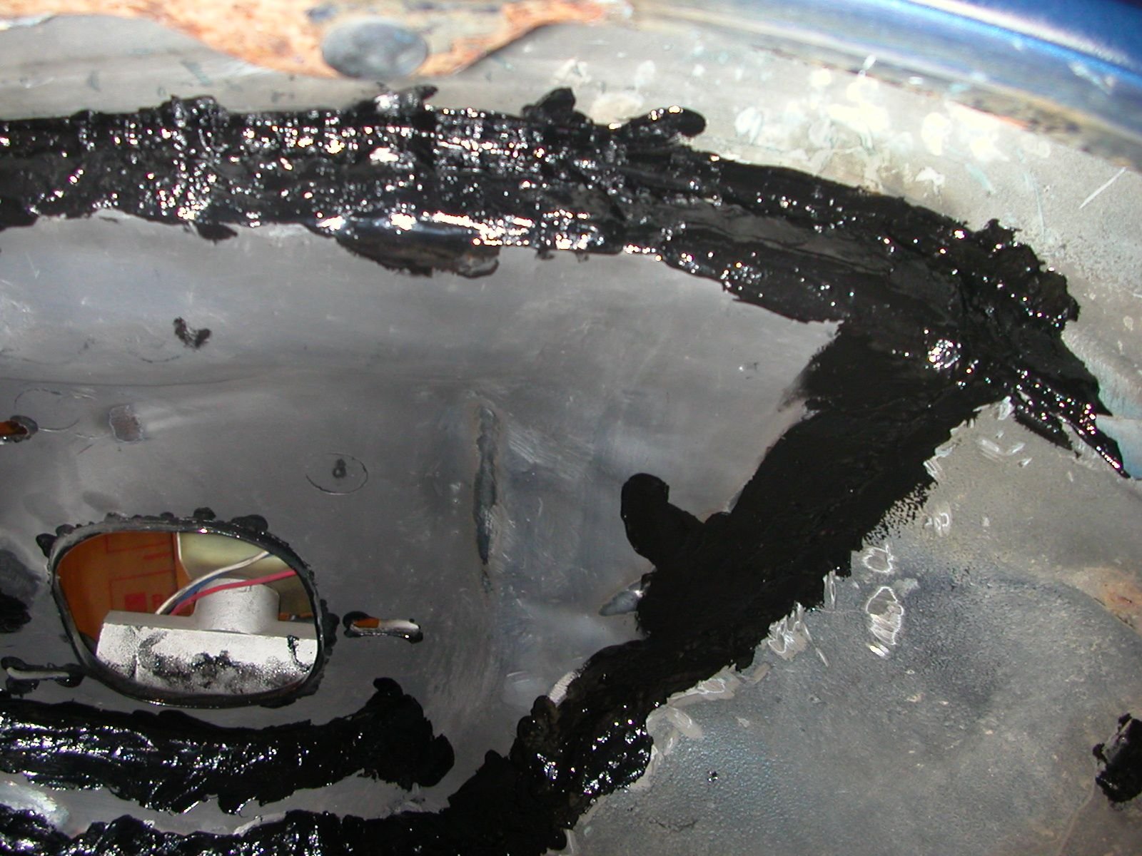

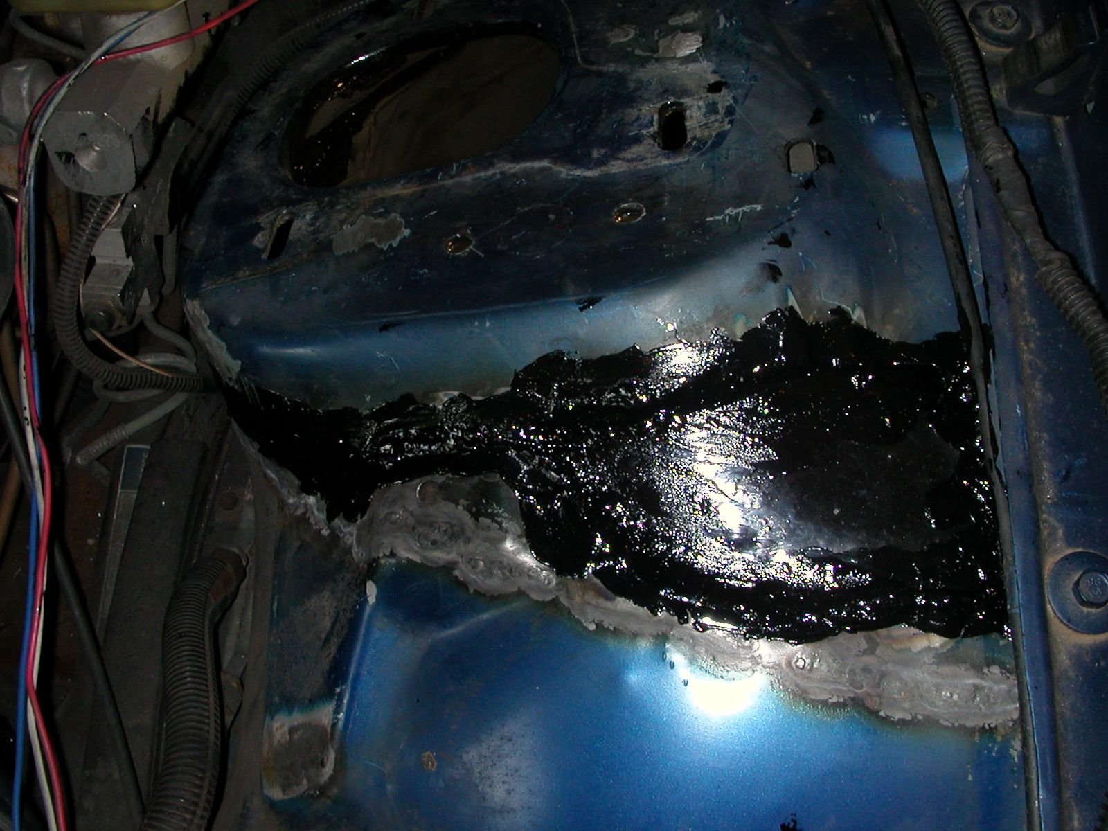

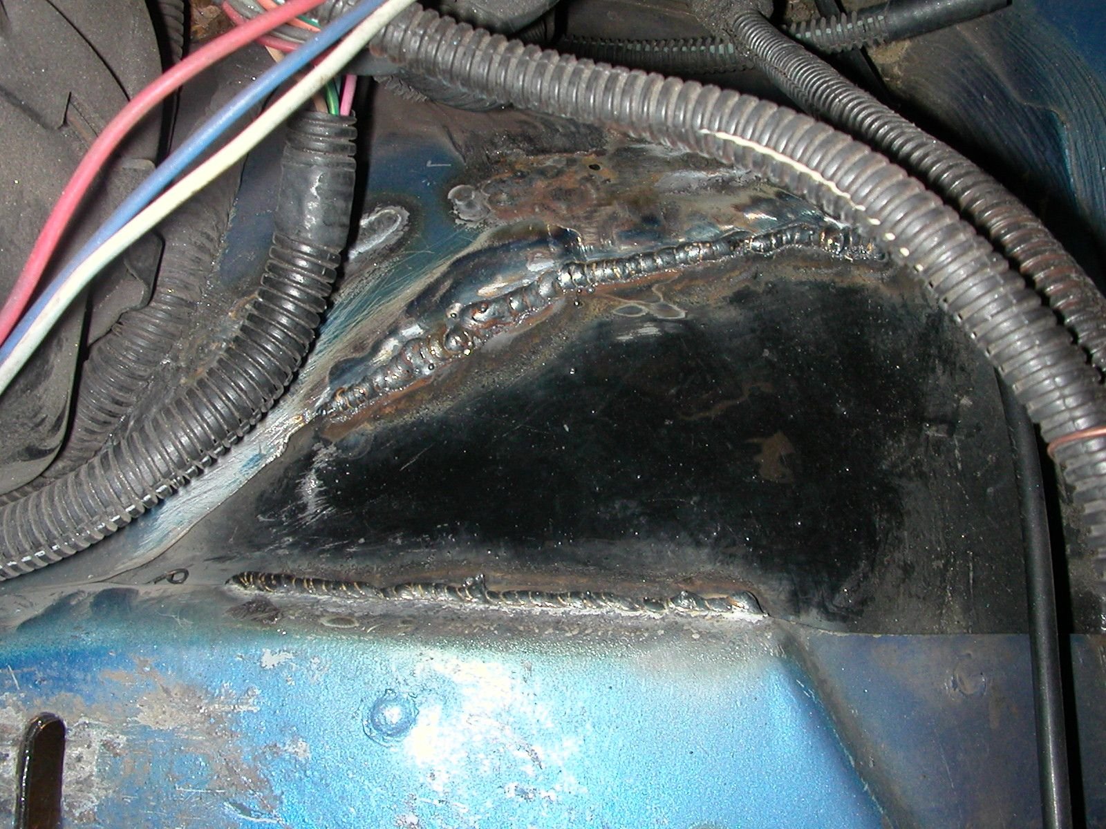

After grinding, I applied POR Patch to all the seams to make sure my less than optimal welds would be protected...

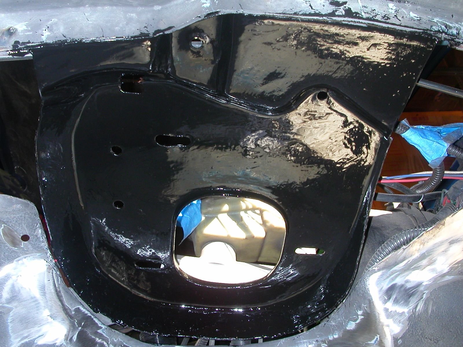

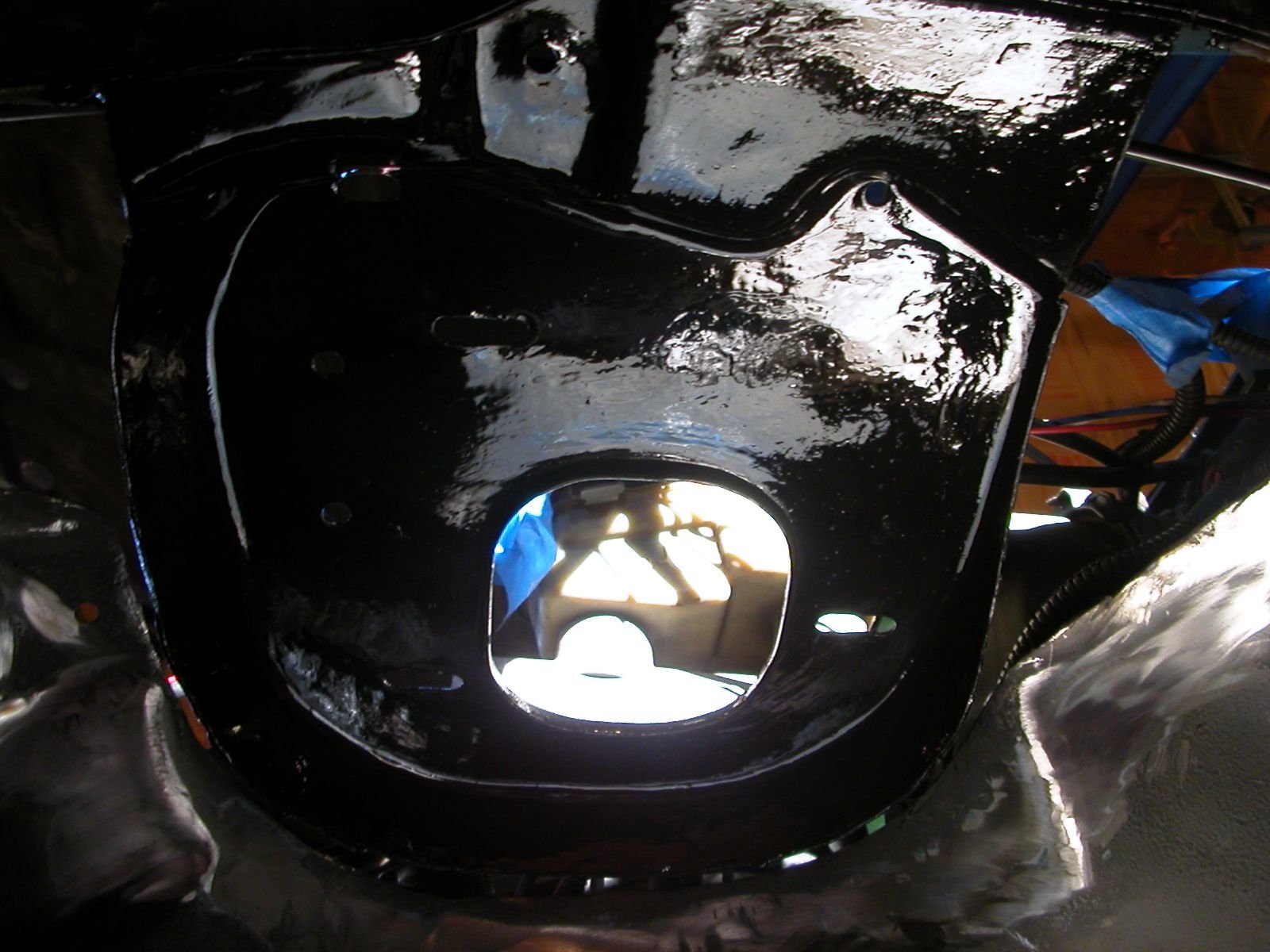

And finally a finish coat of POR-15, ten years later it's still in perfect shape
